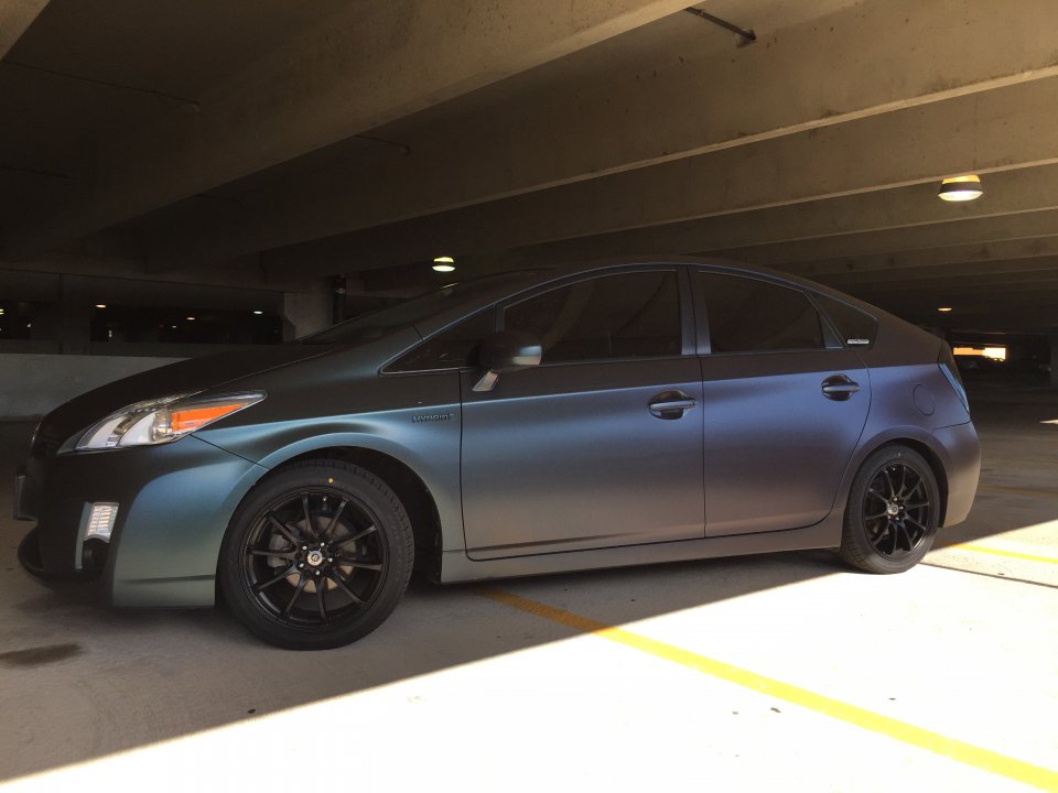

    image.jpg i figured I would see if there are other prius owners that have done full car dips or just parts and post up what you have done. It has been out for a while now but getting more popular.
    Here's my 2010 full dip in beta midnight flip Pearl.

  5. rcs3434
    rcs3434 Member
    Apr 29, 2012
    56
    163
    Danbury, ct
    I didn't dip the spoiler, thought about it but kinda like the how the spoiler blends with the tinted windows.
    I'd say just pick up a can and try it and if u don't like it just peel it off.

  8. rcs3434
    rcs3434 Member
    Apr 29, 2012
    56
    163
    Danbury, ct
    I have a total of 5 gallons on the car from my first color (2 gal, I should've used 3 but my first go at it) to now changing to this Pearl.( 3 gal to make sure it's thick enough for durability, since the first color started peeling in spots)
  9. rcs3434
    rcs3434 Member
    Apr 29, 2012
    56
    163
    Danbury, ct
    I did it myself

    Nice! From the picture, it looks pretty smooth! How long did it take to do it yourself? Did you apply it in a garage or outside?
  11. rcs3434
    rcs3434 Member
    Apr 29, 2012
    56
    163
    Danbury, ct
    If you have the right equipment and apply properly it will come out smooth. I think it took me about 3 hrs of prep time the night before to wash and mask off, then about 3-4 hrs to spray with 15 min drying time inbetween coats. I did it in my garage, wouldn't risk outside too many factors, though people do it outside.

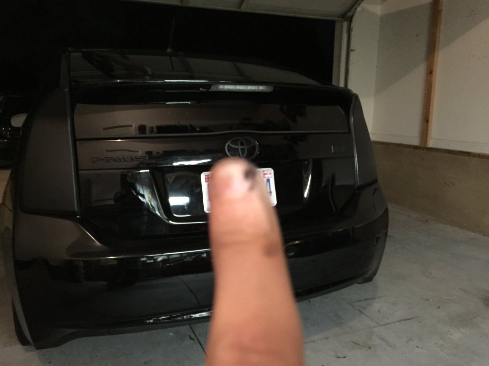

    Hey Guys, New to Forum here! Just picked up a 12' Prius II, Black, last Friday. Dipped the tails and all the badges last night. Looks pretty good and still have good light visibility even with out the LED bulbs. Exctied to keep the modding going strong!

  16. Skyslikeautumn
    Skyslikeautumn New Member
    Nov 5, 2014
    Charlotte, NC
    Nope, I just used the reg. Black. 3 Coats and that's it! I may go back this weekend and do a few coats of the clear to give it a more glossy look to blend in better with the car. Haven't decided yet. I tell you tho, stuff works amazing.
