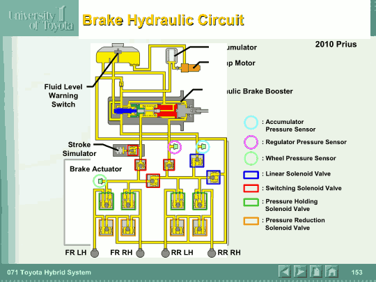

    From Toyota with the brake actuator/ecu shown on top: brake actuator.jpeg

    The booster is part of the master cylinder and, as such, it is part of the other (actuator) assembly. In fact that actuator assembly is often called the "brake booster assembly" in Toyota documents and parts lists. That's also the name used in T-CP-D0H-A510-D, where the same illustration above can be found, but without the name of the upper part erased:
    If you look at it schematically, the booster pump assembly is just the two components drawn in the top right corner here ("accumulator" and "pump motor"). The booster is a small chamber at the rear of the master cylinder where the pressurized fluid boosts your pedal effort by pushing on the piston in the same direction you are.
