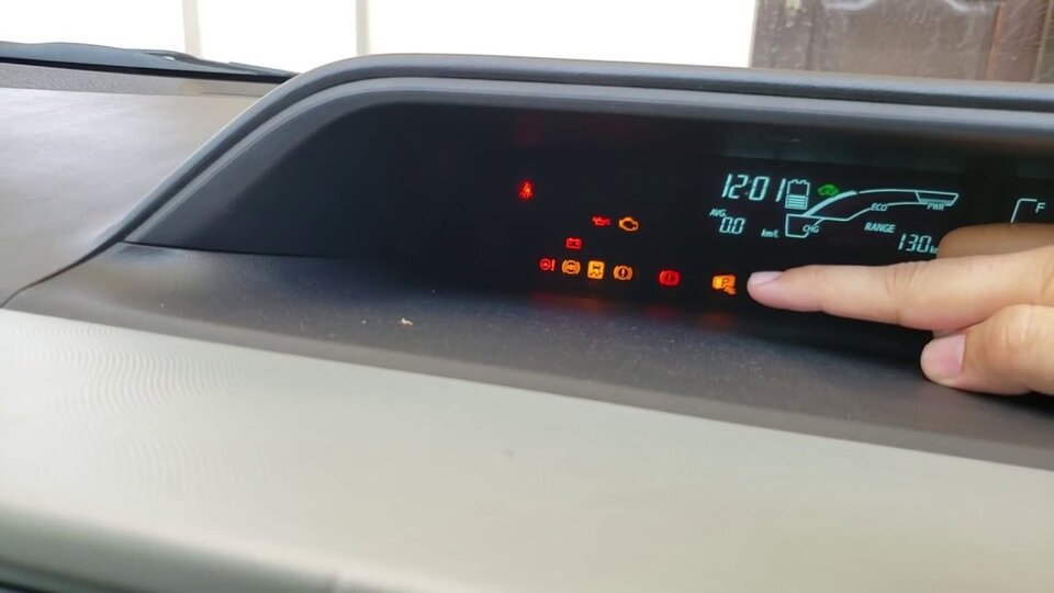

    Recently I was driving through an automated car Image 1.jpg wash and a warning symbol appeared on my 2015 Prius V that I've never seen before (see attached image - the hand is pointing to the symbol, it was like a book with a large P on it and had an arrow pointing to it)
    I've searched through many images of the Prius warning indicators but can't locate what this is or what it means

    Almost looks like “shift to P” or put the car in Park.

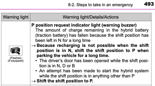

    This. @Slater, the car wash was the pull-along style, requiring cars to be in Neutral? Prius don’t do well in that scenario, since the car has to be on, in Neutral, and for whatever reason, the hybrid battery cannot be charged in that gear.
    Car washes where the car is stationary and the equipment passes along the length of the vehicle are preferable.

    Thank you for your reply. As I stated, this is the same car wash I've used for this 2015 Prius V (and my Prius 3rd Gen) for 6 years which uses the pull-along style with the car in Neutral - I've just never seen this warning indicator before

    It means they took too long with the car in neutral to get it through the car wash and your hybrid battery was getting too low since it can't charge.
    If they had shut off the car without letting the engine charge the hybrid battery after the car wash your car might not have started. A jump would not help.

    That it hasn’t happened before at a pull-thru car wash, could that suggest the traction battery capacity has deteriorated?

    Not because it's not happening. Any protracted time in Neutral is pulling down the hybrid battery, with any generation. For various reasons, it was severe enough this last time to trigger a warning. I would heed it, look for stationary style car wash. In lieu of that, be sure to go into the car wash with minimum peripheral loading: cabin ventilation and music off, nothing plugged in and charging.

    the trigger is usually entering the car wash with a fairly low state of charge and a/c on.
    the older the battery, the higher the likelihood

    The most common way I see to trigger low battery in a car wash is when the vehicle that just finished can't be moved which shuts down the conveyor.
    The guy moving the cars to the car wash tunnel should turn off the ac and lights which minimizes hybrid battery discharge.

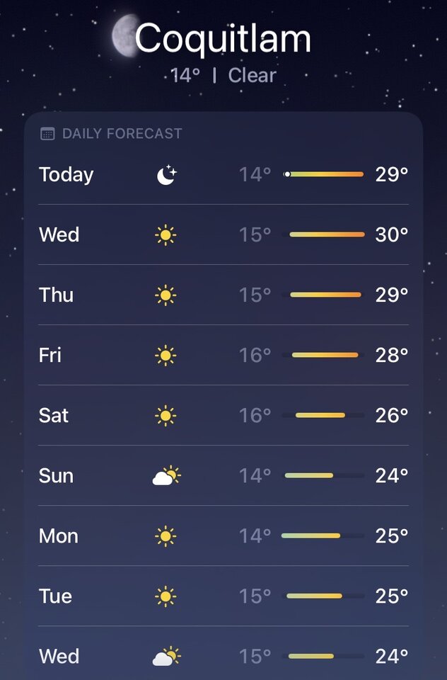

    Rain seriously? This is a dry, dry, rain-free year on much of the PNW.
    Being along the coast, I assume no smoke issues?

    Yeah wishful dreams, car can get dusty. Good house painting weather though. :)
