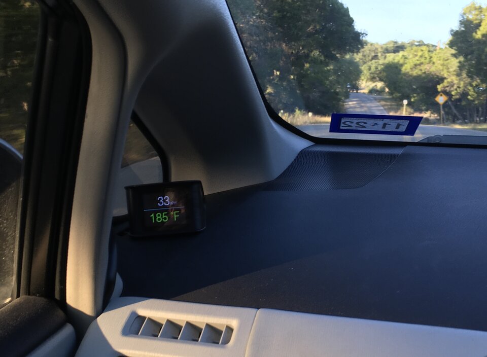

    I have never changed my water pump in 350k miles. But I do have a temperature display with an early audible alarm.
    P10 display $35
    Change the fluids. Save for a new hybrid battery.
