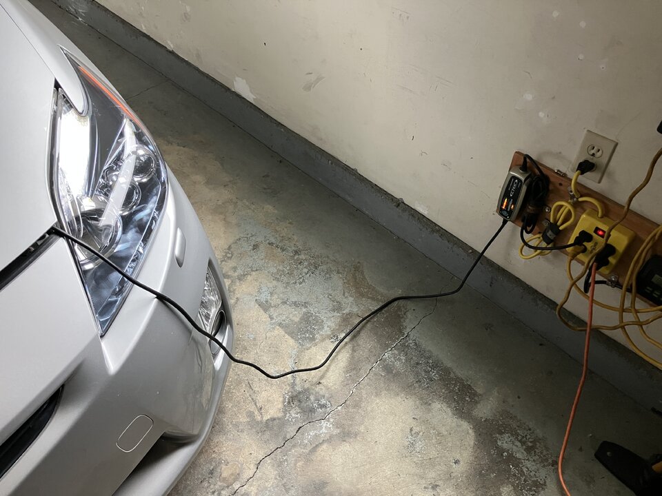

  11. Mendel Leisk
    61,488
    42,309
    We were looking for excuses to drive, to keep the battery happy, and then started thinking "this is nuts". Current situation:
    Working well, current battery was installed in September of 2015.
