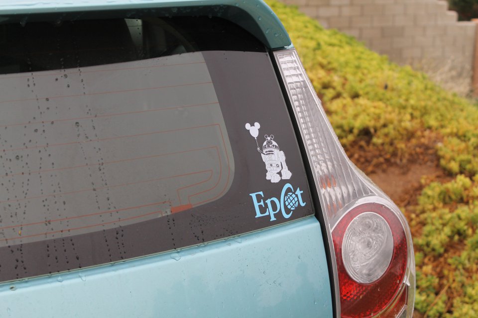

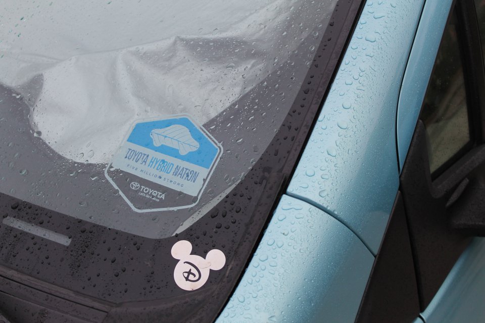

    Added a new decal :)

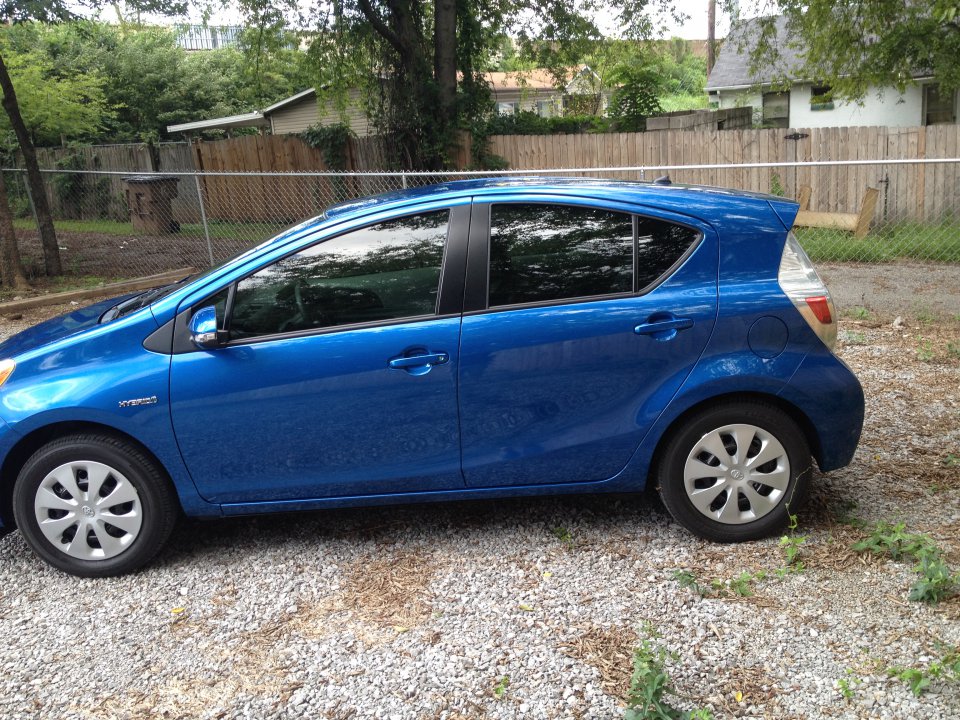

    35% tint all around with sun visor!

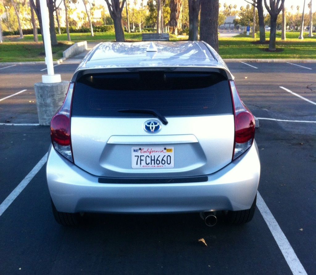

    here's a pic of the side view I posted a few weeks ago http://i.imgur.com/vIUJXMY.jpg
    It's not vinyl - they're modified original taillights from Grazio & Co.

    Nice rear end…. Did you add an exhaust or just a tip? Looks clean….

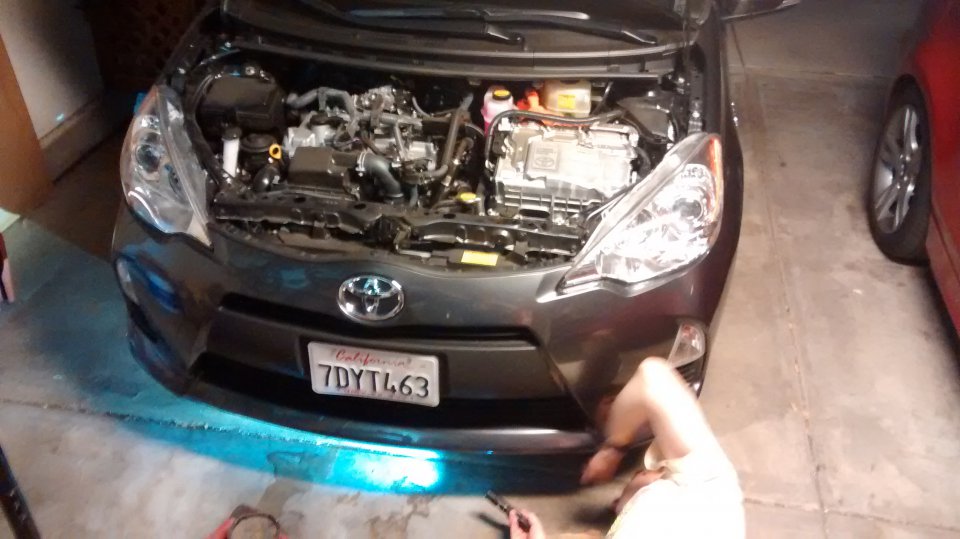

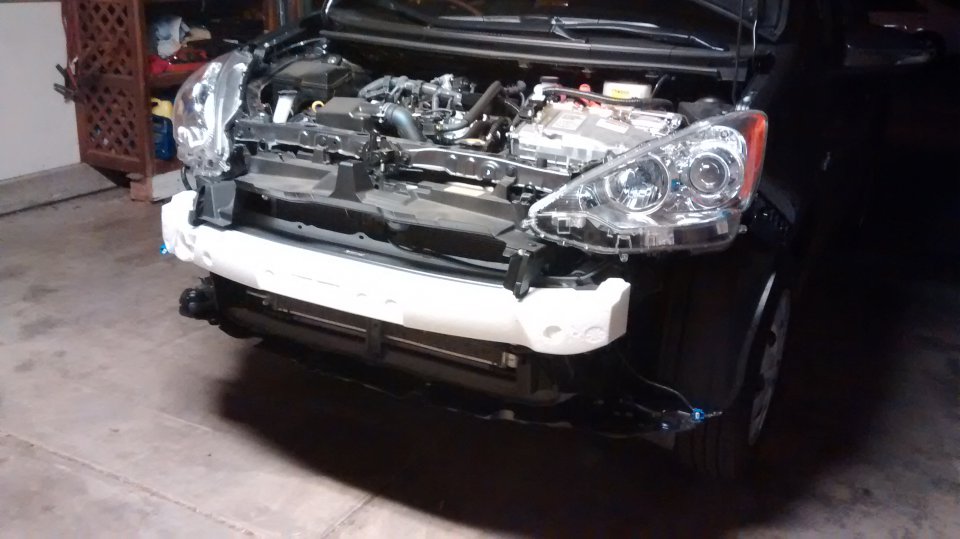

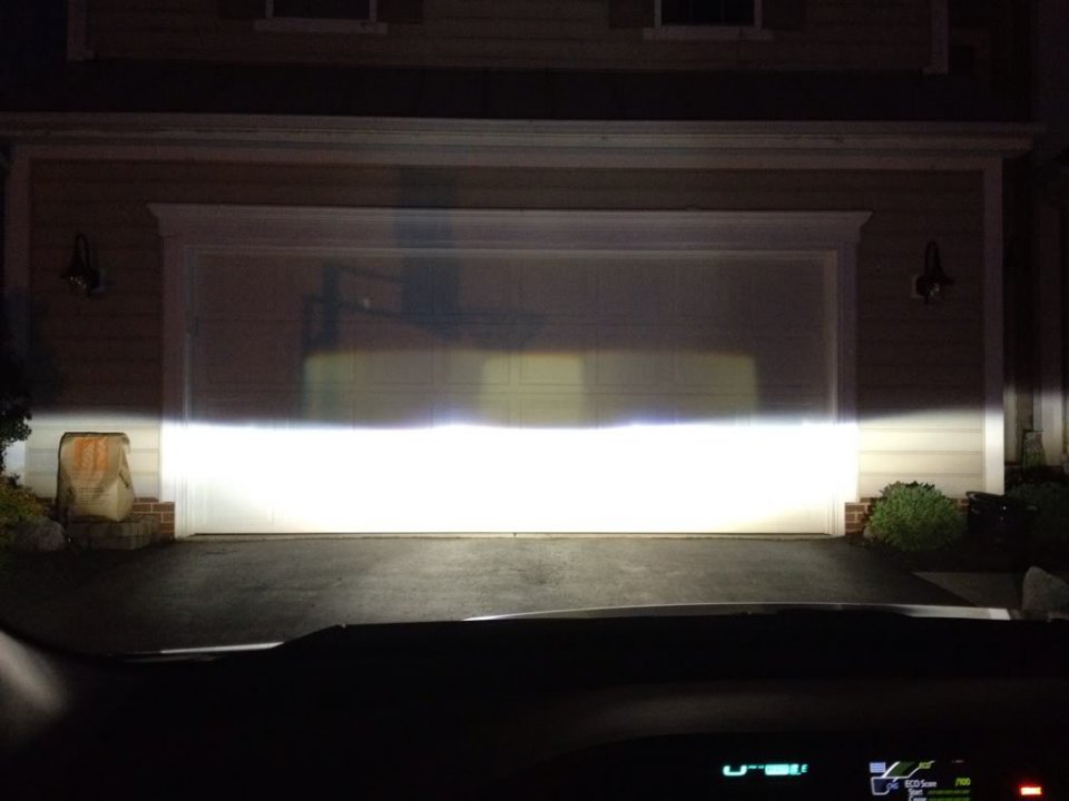

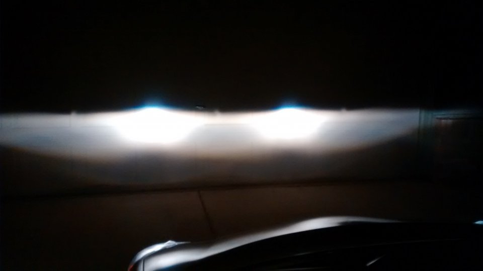

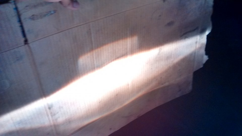

    So I went ahead and bent my squirrel finders. I want to get HID's soon and wanted the flatest cut off I could get. I wanted to do it right, so instead of just inserting my finger blindly and bending I took the headlight out and tried to go slow. Towards the end some of the squirrel finders were starting to "taco" so I stopped bending. I might have over done it by a bit, but it's still better than the original as far as glare for other drivers.
    BEFORE:
    AFTER:

    I'm very satisfied with them - they definitely give the car a more refined look. It's kind of my MO to buy a
    Thank you! It's an exhaust.

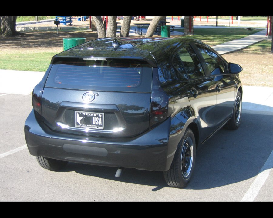

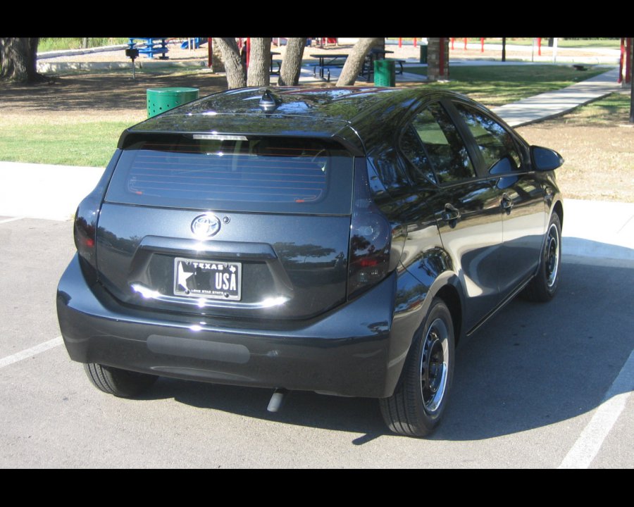

    Finally have the tail lights pretty much where I'm satisfied.
    They are the OEM DIY modified at minimal cost.

    ^ More info and night time pics!

    now those are some nice taillights! :eek:

    ^ Need them! Looks so much better than the 10 year old style altezza tails we are running with.

    Thank you.
    First, some time ago, I painted the sides of the lights with matching OEM color. I made some templates and cut vinyl covers for the turns, back-ups and stops. The vinyl started to weather and I could have cut some more ... when I was seized with the desire to have something a little more permanent and better looking
    .Prepped the surface by polishing off the residues of the vinyl etc. (Meguiars 105, other polishes will work) Wiped down with prep solvent to remove any residual grease. I cut some 3M edge to edge tape to mask some 'windows' over the areas where the turn signal, back-up, and stop light bulbs are located - the reflectors as well. Edge to edge is thinner and when cut with an exacto knife, leaves a sharper edge than conventional tape. The sides already painted were masked as well.
    Then applied 3 coats of VHT NITE-SHADES. Removed the masking tape and applied 1 more coat to blend the 'windows' into the darker area.
    After a couple of days, polished out by hand (105 followed by a finer polish). 105 will remove paint as it polishes and you can judge just how much you'd like to remove by checking periodically. That's it ,basically. At some point I'll clear coat when I am certain about everything.
    More pictures to follow. I should mention that night shots will look almost exactly like OEM. Right now the stop lights are plenty bright during the day and I haven't messed with the third stop light - it doesn't bother me yet. I would like to get brighter turn signal bulbs - might have to go LED. If anyone has any suggestions, I'm listening.
