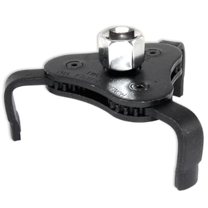

    Tried to change the oil…. Couldn't get the damn oil filter off… tried everything… So pissed off…. I purchased every device known to man to get the damn filter off with no resolve. … Damn dealer put it on to tight….. Grrrr…
    Had no choice but to change the oil and leave the old filter on until next change…. that or put the old oil back in the engine….. I'm so annoyed and frustrated… Nonetheless the car does run smoother now..

    I got the similar problem when changing oil for the first time. This is the one I gotta stop in the middle of the work and had to drive to the Pep Boys store on that Sunday to buy it:
    Pep Boys
    One stupid question: did you turn the right direction to open the oil filter?

    You need one of these. I've been using mine for more than 15 years and have yet to see a filter I can't get off.

    Thanks tk….. ordered….

    That's what I had thought… so I turned the other way too…. nope wouldn't come off either direction… lefty loosey righty tighty
