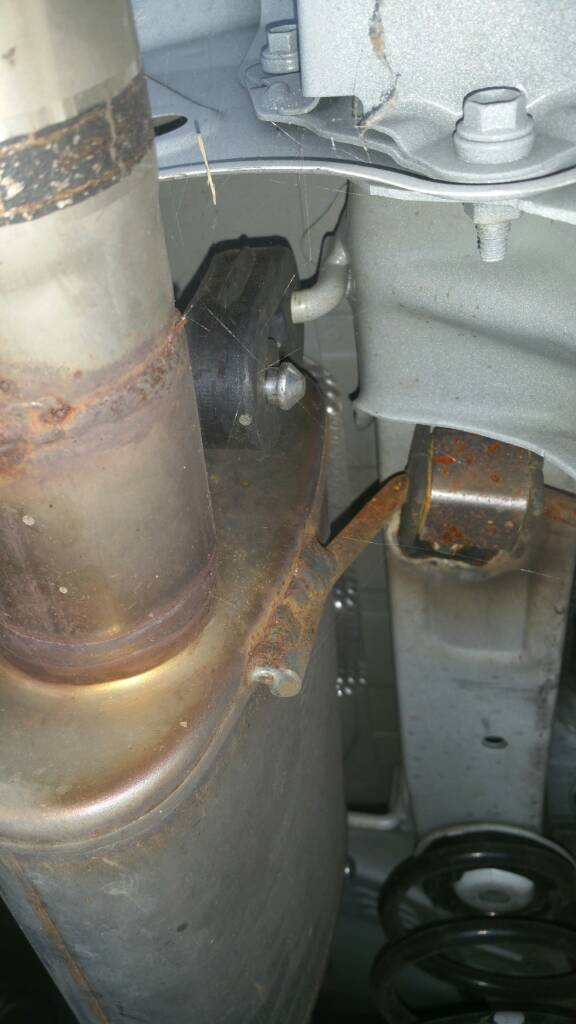

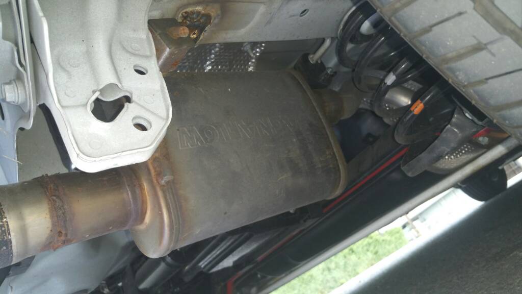

    [​IMG][​IMG][​IMG] ain't pretty but it works. I am putting some rustoleum on there as we speak, ha ha.

    lol after looking at the pics my reply was just going to be rustoleum!, but then I read your actual post. Nice work!

    Been on there about a year. I'm debating blacking out the muffler as well.

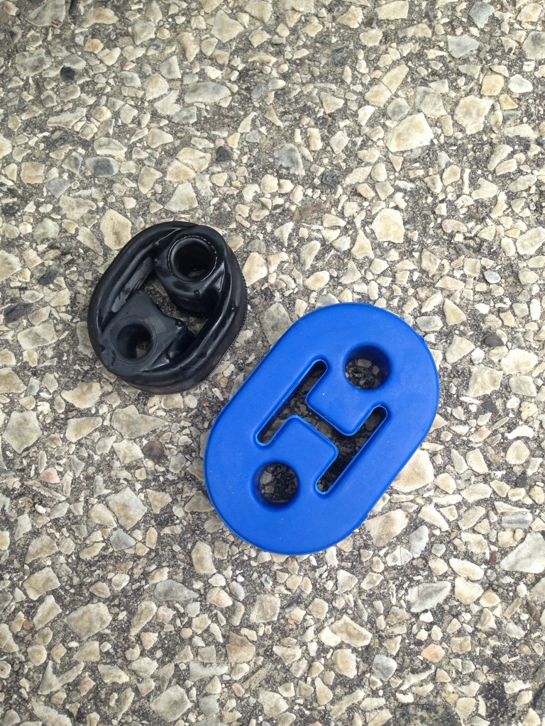

    Thanks for the pictures. I ordered different rubber hangers. They'll be here today, so I'm hoping they'll do the trick.

    These (blue hangers shown below) seemed to do the trick. I just went for a quick spin locally and didn't hear any smacking.

    They most likely won't. I did the same thing. Very tight quarters up in there.

    Just wait. Big turns Ala on and off ramps are when the clanking would happen. I bought those exact same hangers. I also didn't like that my exhaust hung a little lower although that is part of the solution. Happy trails and good luck for it being a permanent fix they sure as hell weren't for me.

    So far, so good! They are significantly less flexible than the stock hangers. My exhaust was smacking constantly, not just turns or bumps. They do hang a little lower. I don't mind, though.

    Interesting add I had the same ones. Well worst case it happens and you can show your exhaust specialist what I've done. Works a charm.
