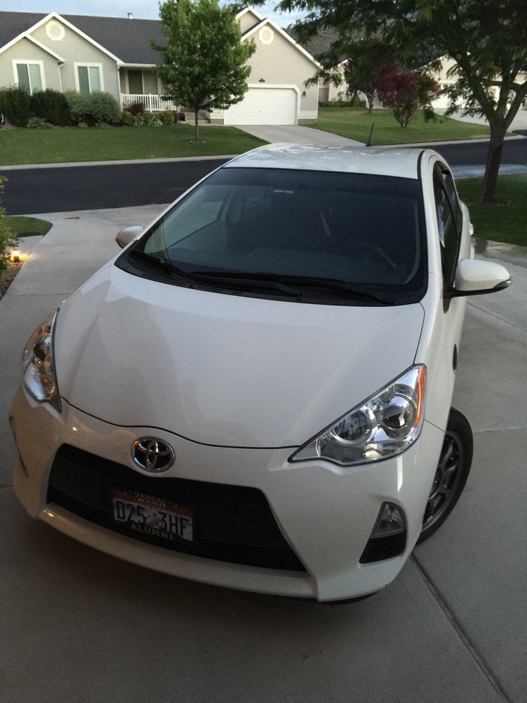

    Added weather tech visors and a tint strip across the top of the windshield.

    Those scuff plates are sweet, not sure about the curtains I'm pretty sure there's not enough room to camp in a C.

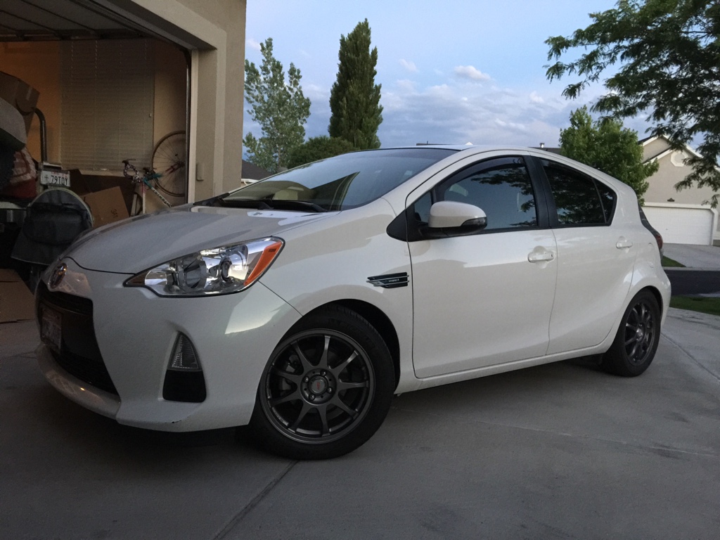

    Fan of your wheels. Can you tell me more about them or where you got them? I think they look amazing.

    Kosei k4r
    Finish: Light Grey Painted
    Weight: 12.8 lbs.
    Offset: 45mm
    I got them from tirerack. They are Japanese made. I am running 205/50 tires. They rubbed at full steering lock so I added 10mm spacers. A 195/50 might clear without rubbing. I have been very happy with this setup.
