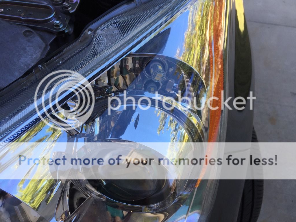

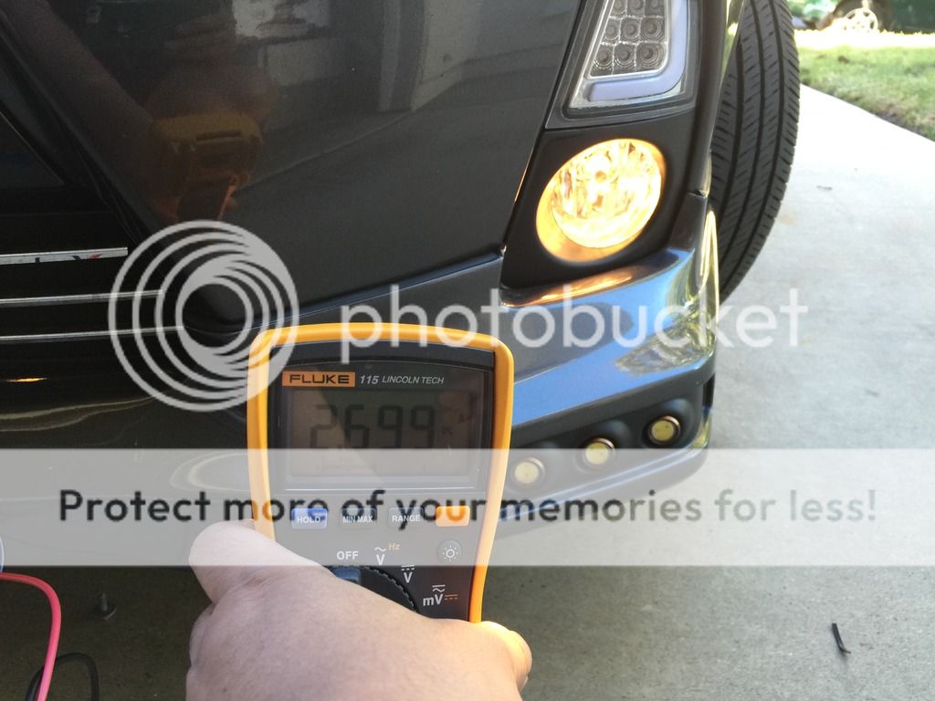

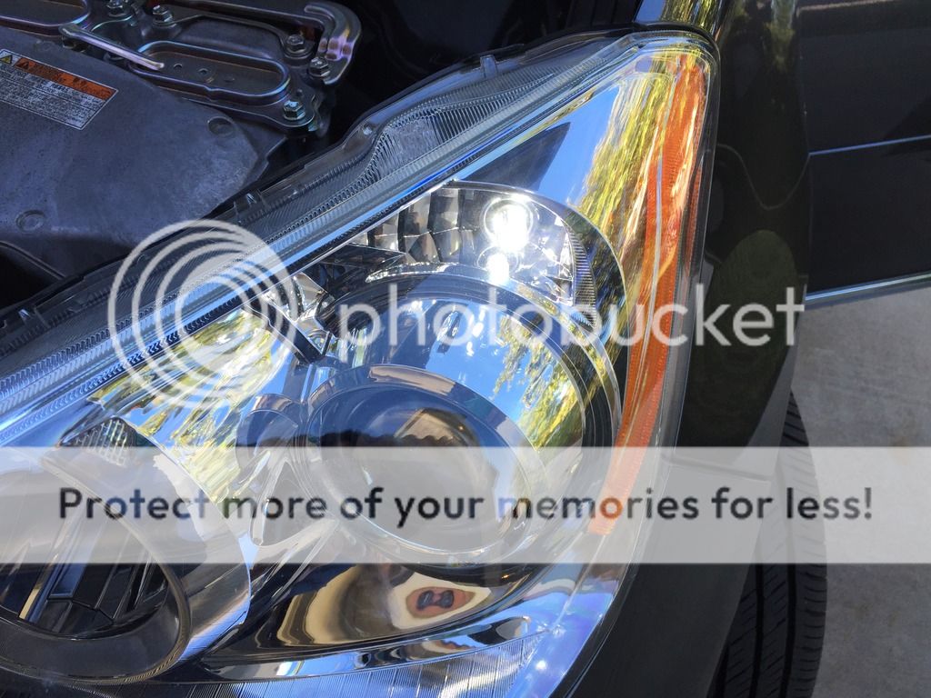

    [​IMG]Replaced front parking light with an LED.
    [​IMG]Front parking light lit. Amazingly white compared to the default amber oem one.

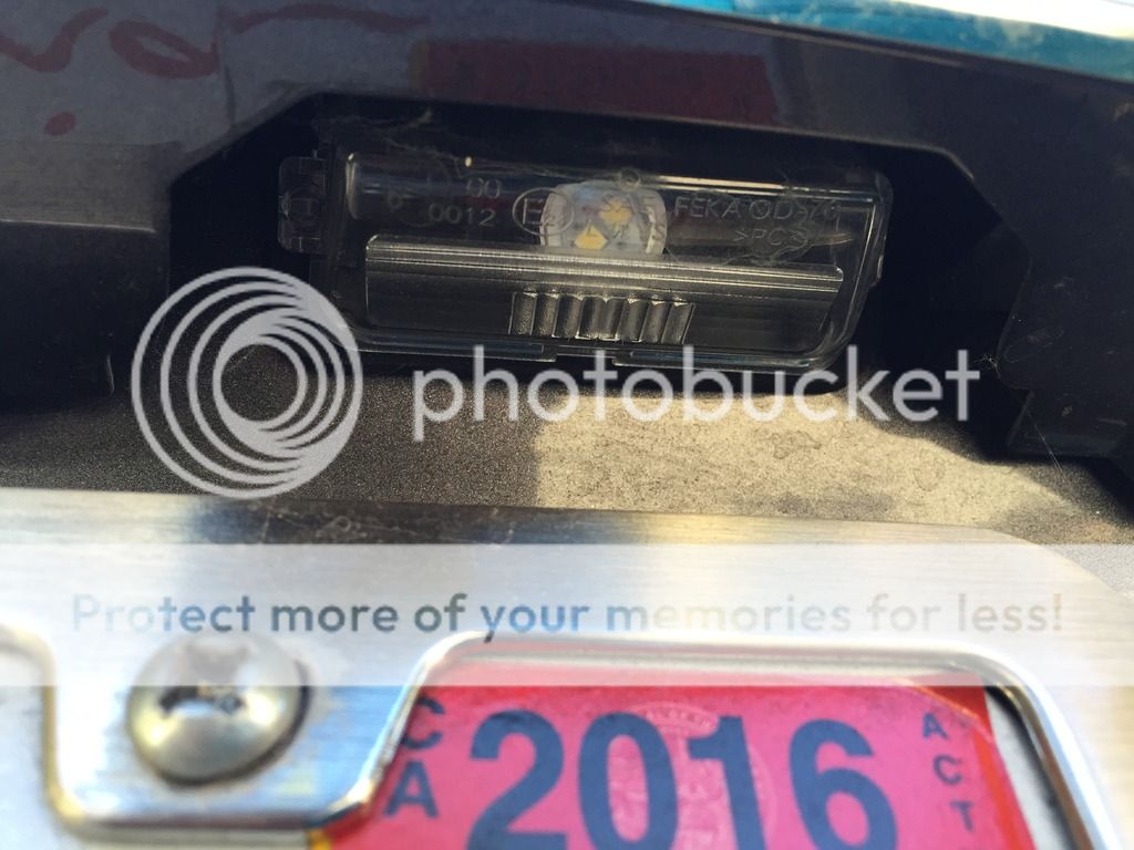

    [​IMG]Replaced lic plate bulb with a 1W LED

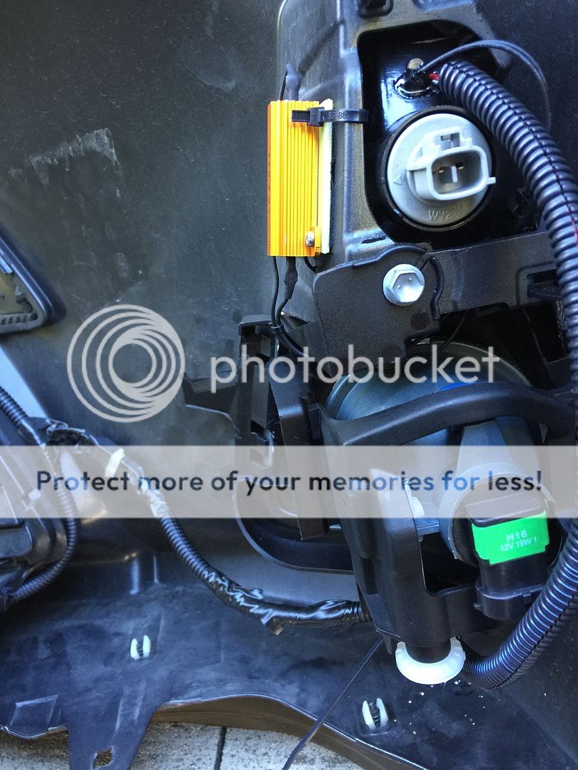

    [​IMG]The backside of the passenger side turn signals and fogs, along with wiring I put together to power everything.

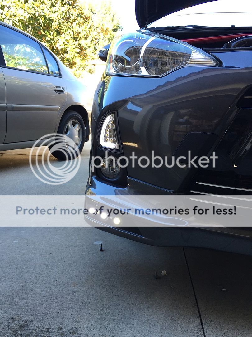

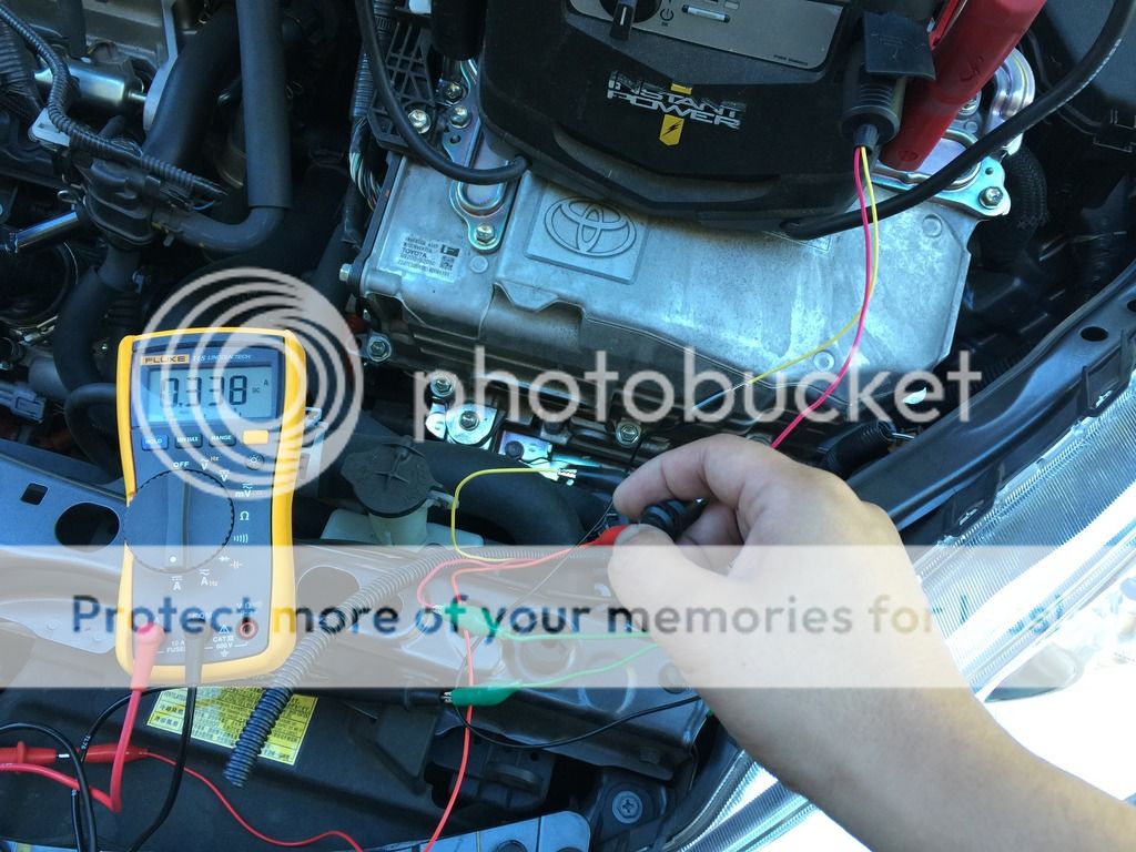

    [​IMG]Newly installed DRLs taking up about 350mA
    [​IMG]Testing the DRLs before I bolt back in the fender.

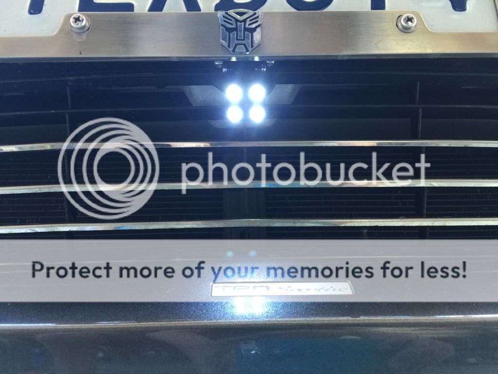

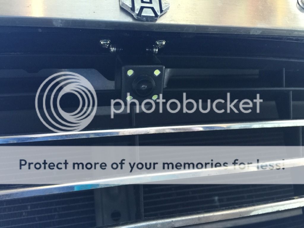

    [​IMG]Forward parking camera tucked under the front lic plate, facing 45 degrees down.

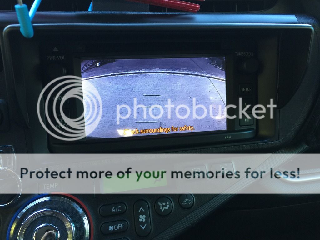

    [​IMG]Front camera lights up when turned on. Not sure how I feel about that yet.
    [​IMG]Forward parking camera adjusting to where I want it
    [​IMG]Testing the fogs before I bolt everything back up. Shows I need a fuse to cover ~3A of power.
    Still have to make switches/relays and stick them in the console, but the bulk of the weekend project is done. Next weekend, weather/work/classwork permitting, will be solar panels on the rear view mirror and the rest of the switching to make the fogs and DRLs work.

  19. mertechperformance
    mertechperformance Active Member
    May 5, 2014
    532
    126
    Nor-caL
    2013 Prius c
    Random question for ya, where/how did you route wires from grill to inside the car? I have a front camera but found no feasible way to push wires through other than drilling a hole facing downwards. very space limited and didn't want to punch through main loom's grommet and tear it.
  20. djdawn
    djdawn Active Member
    Aug 17, 2014
    256
    116
    Escondido, CA
    2014 Prius c
    Heya. I followed the path this fog install used:
    http://www.trdsparks.com/install/00016-47160inst.pdf. In short, they get you to pierce the grommet that holds the hood release cable in place and run your wire in through there. I used this same method for the radar detector, DRLs and forward camera.
