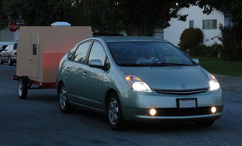

    I've towed a 750 pound travel trailer about 1500 miles with my 2006. The power is adequate for freeway speeds so long as the hills aren't too long. In California, that means north/south, not east/west. The grapevine (I5 north of LA), is about the limit, and required backing off to about 50 mph on the split road coming north out of LA. No way would I even attempt going over the Rockies.
    In California brakes are required on any trailer over 1500 pounds. They would be useful even at 750 pounds.
    A Scangauge or Torque monitoring temperatures helps with knowing when to back off. I just used water temperature, but MG1/MG2 would probably be better. On a long pull, you can exhaust the traction battery, which leaves you with the gas engine only (85 hp?). Just join the trucks in the slow lane to give the engine a chance to recharge the traction battery. When you stop, leave the car in Ready for a while to keep the traction battery fan running.
    In terms of handling, I think the Prius is comparable to a Corolla. It's no truck, but it is capable of towing a small trailer. The major difference from the Corolla is that the gas engine is less powerful. The traction battery / electric drive makes up for the lower power engine, but it can be drained by an extended long pull.
