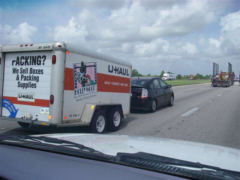

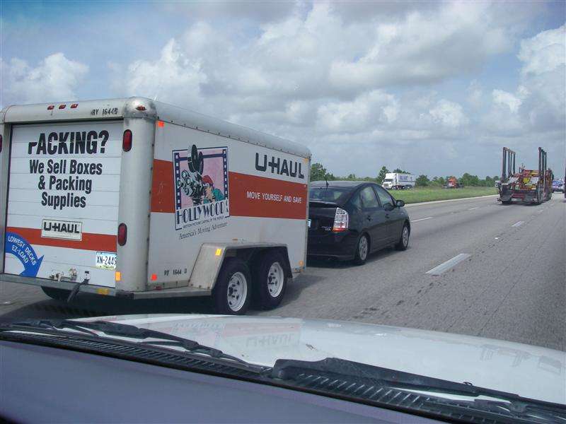

    I have misplaced the pics I took during the install but here's one that shows it in use:
    http://nevils-station.com/stuff/prius/setup-fd2013-2.jpg

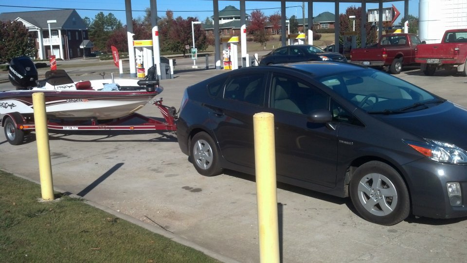

    I tow a 16.5' bass boat. I have around 200 miles so far with no adverse effects. I drive carefully and the engine and brakes seem to handle it well.

    I'm sure everything went fine, but that pic scares me.
    I see the front of the trailer dipping way down, and the back of your Prius also plunging. It looks like handling might have been a bit awkward at times.
    Nonetheless, congratulations on using your Prius to tow an impressively sized trailer.

    I'm a big fan of using passenger cars for towing (used to use subaru for 18' boat towing), but this is clearly crossing the line. One can cheaply rent a bigger car or truck instead that kind of unsafe stunt.

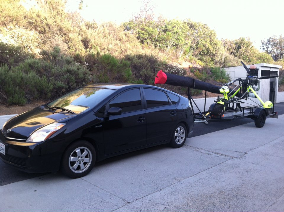

    What I plan to tow. E-LSA trike, total weight with trailer about 900 lbs. Tongue weight is about 40 lbs.
    Questions:
    Are there any upgraded brake pads and shoes?
    Planing to change the transmission fluid. Local shop suggested doing a change, driving a short distance, than changing again... is this over kill?
    Any other suggestions from people who have towed with Prius? Upgrades, types of fluids. I have the curt hitch.

    Tongue weight 40 LBS? Total weight 900 LBS ...... You will be OK!!
    No upgrades needed!!:)
    Beware of high speeds, high winds; could lead to sway.:eek: But you know that,if you drove big rigs.
    If you pull 1200 LBS or more; I would suggest electric trailer brakes; and rear air springs for your Prius.
    Change your oil at 5,000 miles, if you tow with ICE in high RPM's for long periods of time.
    Happy towing!!(y)
