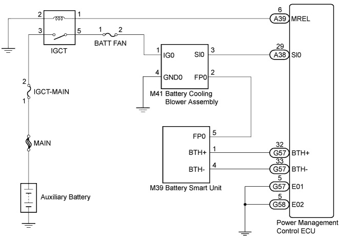

  6. vincent1449p
    vincent1449p Active Member
    May 24, 2004
    894
    332
    Singapore
    No, it only power on in Ig-On or READY.
    The IGCT Relay only turns on when MREL of Power Management Control ECU is turned on, i.e. during Ig-On or READY. At other power state, ACC or OFF, there is no power to the fan.
    The EVAP leak check is internal to the fuel tank and has nothing to do with the Battery Cooling Blower.
    Vincent

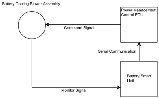

  7. vincent1449p
    May 24, 2004
    894
    332
    Singapore
    Yes, HV system is isolated when no READY is displayed. Please note that the Battery Cooling Blower runs on 12V and not on High Voltage so the car need not be in READY to run the fan. The Battery Smart Unit sends info. such as Battery Temperature to the Power Management Control ECU which then commands the Battery Cooling Blower to adjust an appropriate fan speed.
    Vincent
