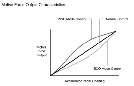

  19. ChapmanF
    27,616
    18,214
    The engine and ECM don't even know the difference between being in power mode and being heavy on gas.
    The go pedal is an input to a different ECU, the power management control ECU. The mode buttons are, also. Depending on the mode, that ECU converts how far the pedal is pressed into a number for how much power is wanted.
    After accounting for how much power to supply electrically, the power management control ECU is left with a number for how much power to request from the engine. It sends that number to the ECM. The ECM doesn't know how it was arrived at.
    mikey_t likes this.
