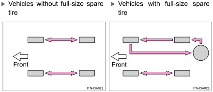

    This is an interesting old thread I had not seen before. I had noticed the way Prius owner manuals switched from cross-rotate to front-back rotate between Gen 1 and Gen 2:
    Gen 1:
    Gen 2:
    Gen 3:
    Gen 4:
    (I especially like how the Gen 3 drawing makes absolutely sure you can't mistake which way is the front.)
