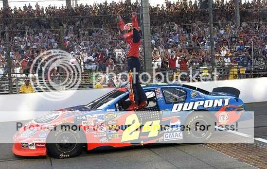

    I guess the term "spoiler" has changed over the years to now refer to the small bump on the rear decklid of some cars which is there more for drag reduction than downforce generation. But back in the old days, when spoilers were huge, they were definitely for generating downforce, and as a result, they increased drag. I'm talking about spoilers like this on the old NASCAR "Car of Yesterday"
