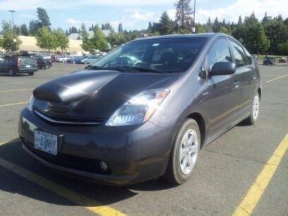

    Looks like you are talking about the Snorkel.
    The outside air flows through it to the engine filter box -- unless mice have made a nest in it. I take off the connection at the engine filter and put the shop vac on it every once in awhile to clean it out -- per Patrick Wong's advice.
    Hobbit, one of the earliest experts on the Prius actually thought it a worthless piece of junk that was in the way, apparently, and removed the snorkel on his Prius altogether.
    The driver of this Oregon Prius apparently thought the car needed a bigger snorkel.
