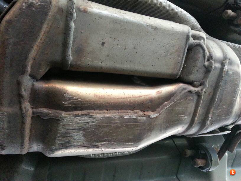

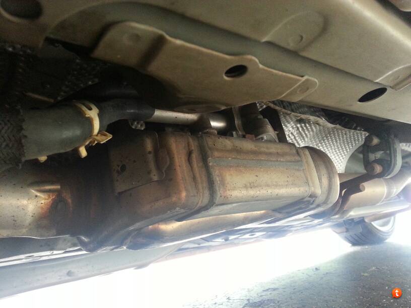

    [​IMG][​IMG]
    So I was messing around with my exhaust again and wondered what is this and do I need those hoses coming off it. Reminds me of the 2nd air pump crap that was on my corolla but it was part of the manifold

  3. Easy Rider
    Easy Rider Active Member
    Feb 9, 2014
    982
    210
    N. Central Florida
    2013 Prius c
    My guess is catalytic converter. If that's what it is, then yes all the hoses are necessary. In general, they don't put parts on a car that are not necessary........for something. :)

  18. pmike
    pmike Member
    Feb 29, 2012
    237
    81
    Central Florida
    99.9% sure that is the exhaust heat recovery system. The cat is upstream from that.
    Neither. Toyota didn't leave any MPGs on the table. Only thing I have seen that has a measurable difference is grill blocking in cooler weather.

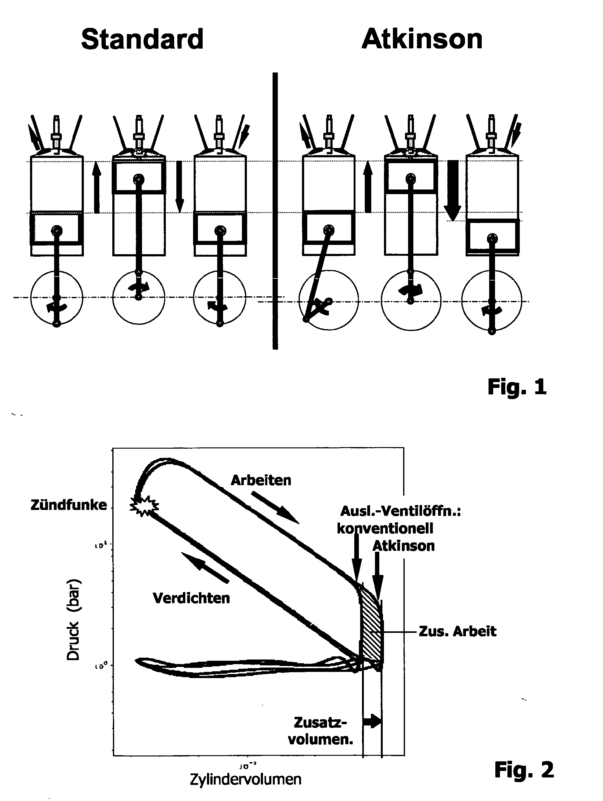

  19. JimboPalmer
    Apr 14, 2009
    12,470
    6,879
    Greenwood MS USA
    The Prius does not have an Otto cycle engine, so old wives tales don't work. You can piss off your neighbors, but it is just louder, not better in any way.
    In an Otto cycle engine the gasses are still expanding in the exhaust, in a Atkinson cycle engine the cylinder area when expanding is larger than when under compression, so the gases can expand more fully in the engine where it does work. (Not in the exhaust where it makes back pressure)

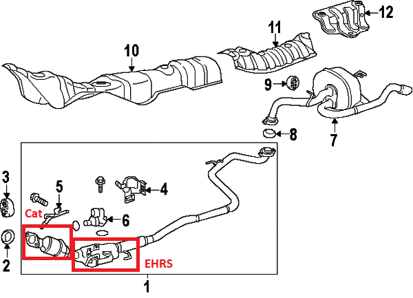

  20. olieman
    olieman Junior Member
    Oct 24, 2014
    Netherlands
    Hallo, my name is Tony from the Netherlands, I have only recently joined this wonderful forum.
    Now, about this funny looking exhaust, it is used to warm the heater water of the Prius C.
    wich is similarly as in my European version the Toyota Yaris Hybrid.
    See the attached drawing.
