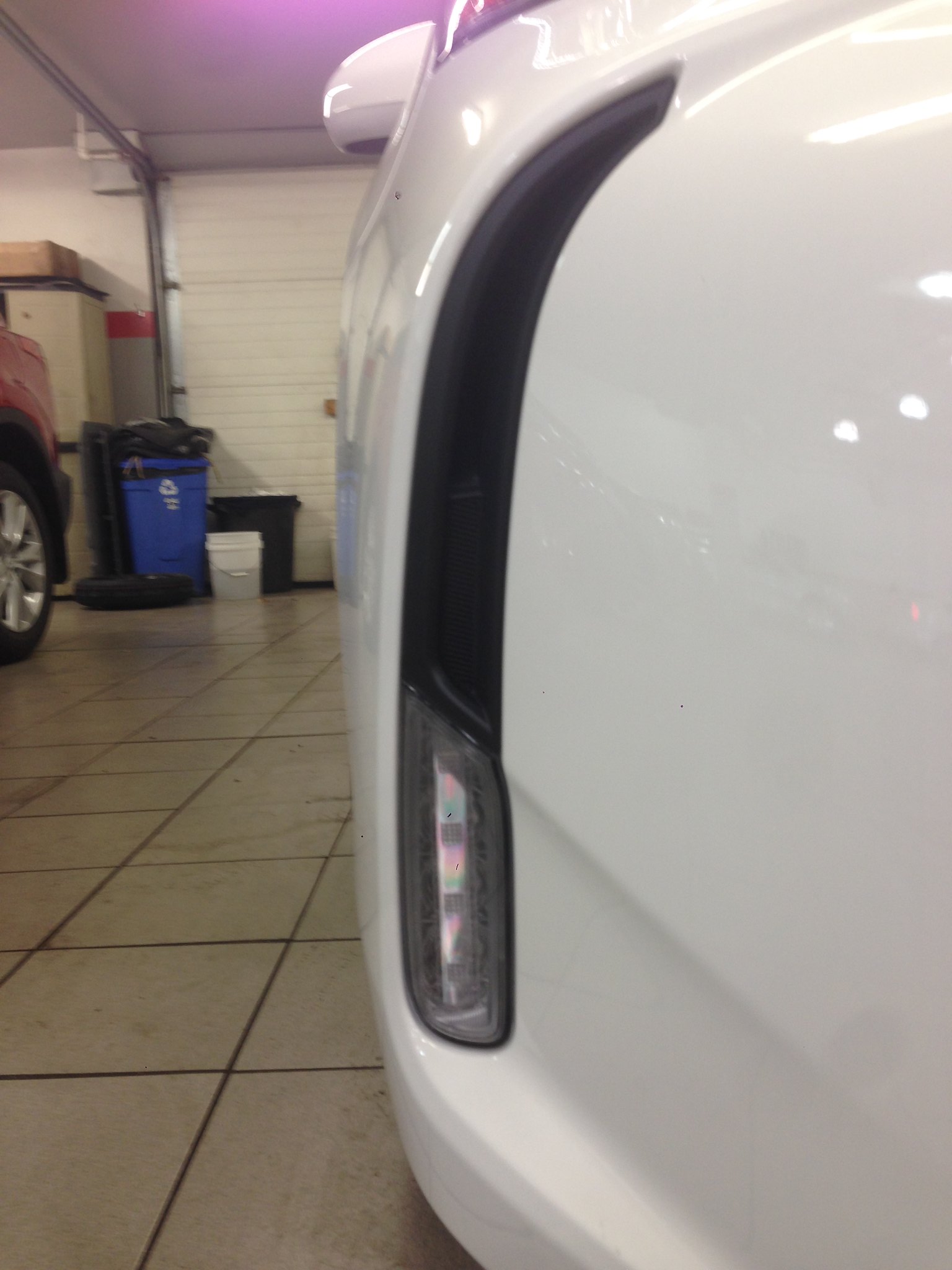

    I'm curious about the lights on the front here:
    Which actually appear to be nothing more than reflectors. They're not fog lights, or DRL's here in Canada, so I wonder if anyone knows what purpose they serve? Are they fog lights on upper trim levels? Mine is a base model so no fancy stuff. Remember this is the 2015 refresh, and the front end is quite different from the 2014's.
    I would love to ditch the stock high beam DRL's for something that is lower voltage and more reliable.
    Any thoughts?

    The 2015 Camry has LED DRLs in that position.
    You can raise the front end and remove one of the corner under panels and see if there is an unused wire harness coming out of that assembly. If there is, then you can probably test if they work using a 9v battery. LEDs are polarity dependent, so if it doesn't work, switch the wire polarity and test both possible polarity combinations. If they are LED lights, then you will be able to get DRL function simply by applying 12v power to the wires by tapping one of the engine compartment fuses that's hot when in Ready mode.

    @rider - I haven't had a look at the underside, I'll try this weekend and snap some pix. I can't tell if it's just a reflector (like the back red ones) or a wired up light. If so, would it be part of the CAN bus or just old fashioned wires? I like the idea of just tapping into a key-on 12v source. But there wouldn't be much point in doing that if I couldn't somehow disable the high-beam DRL's.

    Yes, it would be interesting to find out if they're real lights, or just dummy lights. If they're non-functional, then you might still be able to install the USDM equivalent parts to get what you want.
    You can look for a relay in your engine fuse box for the DRLs. If you find one, pull it out and test all functions of your headlights and highbeams (lowbeams, highbeam switch on, and flash to pass, both with and without lowbeams on).
    Then the appropriate terminal from the DRL socket might be used to power your LED DRLs.

    The dummy lamps the OP is asking about are LED DRL on the 2015 Prius+ sold outside of North America. The EU does not allow high beam headlamps to be used for DRL.
