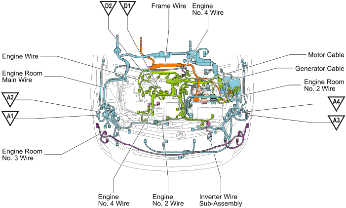

  16. ChapmanF
    28,682
    18,985
    Hold the phone. That one is the light blue one here, runs all 'round the engine compartment, through two different firewall grommets into the instrument panel, includes the fusebox (ask some folks here how fun is removing the fusebox) and so on.
    But I don't think it's the one you want. The injector connectors belong to the green one, just "Engine Wire".
    Even that one would be tedious to replace, and faster to repair if only that one place is damaged.
