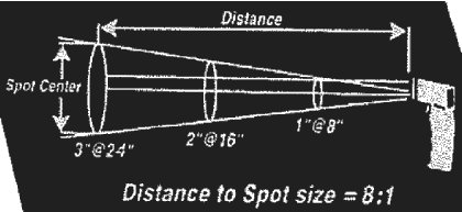

    The same goes when using a IR sensor device for reading temperature the farther you pull it back from the item being measured the lensing surface area it was meant to read at a given distance increases in diameter.
    Example if I was trying to take a temperature of a aluminum pipe that I painted black with a half inch diameter. In the specification for the diameter at 1/2 inch for my infrared temperature reading device was 12 inches away but I was taking a measurement from 16 inches away it would be skewed by having a larger diameter picking up whatever temperature was to the left and to the right behind it skewing the true temperature.
