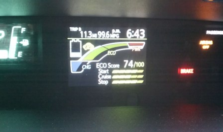

    I use ECO. When I am on back roads and traffic is light I use EV only mode 24mph to ascend the hill as ICE comes on at 25mph in EV mode. This is how I achieved this tonight averaging 22-45 mph:
