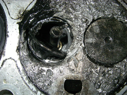

    For non-technical folks, when the piston compresses the fuel-air mixture, it gets hotter as the pressure rises. There comes a point where the fuel-air mix ignites by itself before the spark-plug fires. This is a bad thing because the piston is still headed up but now, too soon, against the tremendous force of the burning fuel-air. There is a type of burning called 'detonation' that is extremely fast. Regardless, this is how "knock" is created. A higher octane rated fuel delays when this self-ignition occurs.
    Often, knock is followed by parts of the engine failing, in particular the pistons:
    This last one may not be due to excessive knock but more likely a valve train failure. Still, it isn't everyday you see a valved forged into a piston.
    Here is classic piston damage from detonation:
    It can damage valves:
    and cylinder heads and all sorts of similar stuff.
