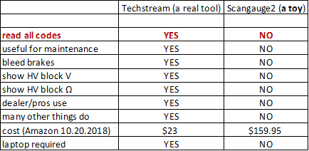

    Ok... And here I read another post that said techstream OR scangauge 2 was fine
    o_O:unsure:
  2. ChapmanF
    27,616
    18,214
    I remember for the Gen 1, vincent1449p had worked out how to program a ScanGauge II to read hybrid and battery DTCs, and even inf codes. I don't know whether the same is available for Gen 2; I would assume so, if one knows where to look. A stock SGII might not read the needed information without the extra programming first.
    -Chap
  3. exstudent
    exstudent Senior Member
    Jul 11, 2009
    2,214
    905
    Torrance, CA
    That person probably likes seeing fuel consumption info, trip time, coolant temp, etc, and may not be concerned with diagnostic/maintenance capability. And may be fine NOT reading ALL codes.
    Yes, Techstream requires a laptop and is installed easily on a Windows 32bit OS (XP, Vista, 7) laptop. Ask friends/family/coworkers if they know someone in IT, for an obsolete laptop laying around. This person will likely have multiples, and can give you a free one. Mac install possible, you need to search.
    Even if you don't DIY, you should still get Techstream. The cost of getting codes professionally read at the dealer is likely $100+. $23 cable/software from Amazon and hopefully a free obsolete laptop, you come out ahead. You could also sell your Techstream setup, recovering some/most of your expenditure.
    Scan Gauge2 is for you, if you just care about the info below, and limited code reading ability.
    #43 exstudent, Oct 20, 2018
  4. ChapmanF
    27,616
    18,214
    The thing with the ScanGauge is that you can see more information with it if you can find the right XGauge information to program it with. Battery block voltages and resistances are definitely available for Gen 1 and also for Gen 3 (hasn't been transcribed into the Sourceforge project yet, but there's a spreadsheet floating around). I don't know what's available for Gen 2, but I would assume much of the same information is.
    That is certainly still less capable than a Techstream rig, but has some other attractions (like, being pretty small and more likely to be in the car with you when you are on a drive and lights come on).
    Also, there are a couple of ways $23 could be considered a lowball estimate for a Techstream setup. First, the interface dongles at that price point are sometimes a bit flaky, and you might want to spend a bit more on the dongle to have one that doesn't flake out in the middle of certain maintenance operations. Second, if you prefer to use the software under Toyota's terms, the rate for a two-day activation is currently $65 in the US ... but remember this is more than just use of the software, it also includes full TIS access for the two days, including the Identifix database and ECU firmware updates. (Personally, I don't think I would ever begin a firmware update using a $23 dongle ... that's one operation I might not risk even with an Openport, or any dongle other than the DrewTech one that Toyota recommends.)
    -Chap
  5. exstudent
    Jul 11, 2009
    2,214
    905
    Torrance, CA
    If you DIY, and/or want to READ ALL CODES, go Techstream.
    If you like seeing instantaneous vehicle info and DON'T mind not being able to read ALL CODES, go Scan Gauge2.
    Remember, this person was content w/ SG2 reporting an invalid code.
