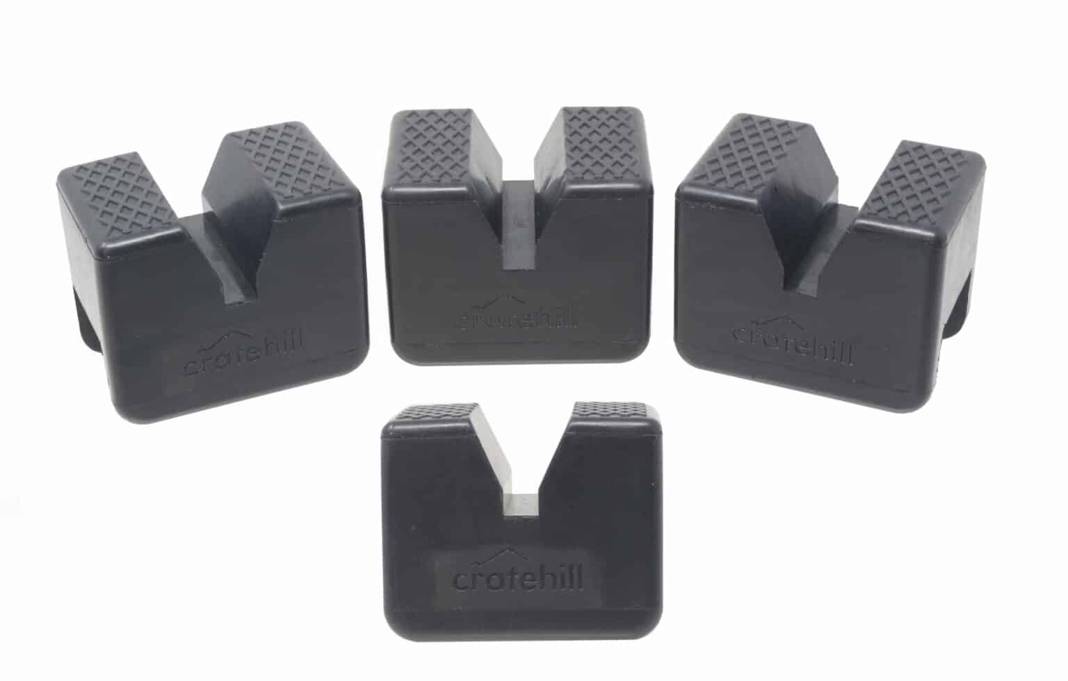

    For the front end, first drive the car up on a pair of 2x10x~16 boards, chock the back wheels, then use a 3 ton floor jack on the front jack point, jack it up, and put jack stands on at the pinch weld jack points. The jack stands have these (same shape, not same brand) rubber pads on them, otherwise they would put weight on the body and not the weld.
    For the back the boards can be skipped. They are only needed on the front because without them there is zero clearance between the jack handle and the bottom of the car, and it isn't possible to pump the jack.
    One of my boards broke the last time I used it, and I will be making a set of short ramps like the ones in the bottom picture here

    The way the (old, but not recalled, Harbor Freight) jack stands were landing without the rubber inserts wasn't great. One side of the "Y" was touching the body, the pinch weld wasn't cleanly sitting at the bottom of the valley, and the other side of the "Y" was hanging out in the air. With the insert the pinch weld is sitting firmly on the rubber, and to the extent the body is touching the insert, it is on rubber and not metal. The rubber deforms temporarily where the weld sits, which is better than bending metal on the car.
