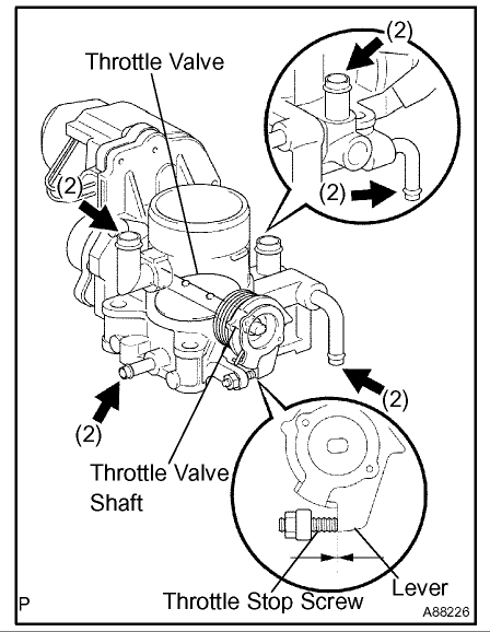

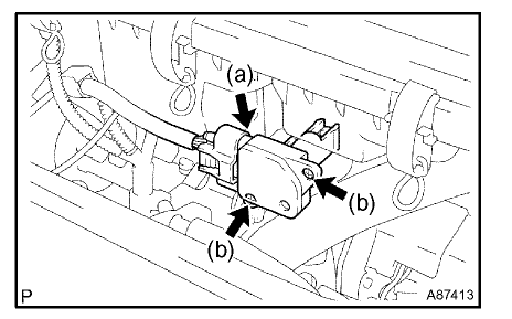

    It's best to remove the MAF. This is extremely simple to do on the FJ Cruiser, and simple enough on the Prius
    The Prius has electric throttle, but the return spring on the end of the shaft can be manually rotated with your fingers. Never, ever poke a screwdriver or other object down the bore
    I use TB cleaner on the TB, and MAF cleaner on the MAF

    On the FJ Cruiser, it also has an electric throttle, but no external return spring. I have to have the motor off, Ign on, and have a helper keep the gas pedal floored while I clean the TB
    A note on cleaning the MAF and TB: more cleaner is NOT better. If you spray too much cleaner into the intake, you will have a hard time getting the motor started. A 1-2 second blast on the blade, where the blade seats, and the passages is plenty
    The MAF needs maybe a 1 second blast on the hot wires to clean them. It's optional to clean the IAT bulb, it won't help the performance of it, but since you're already cleaning the hot wires ...

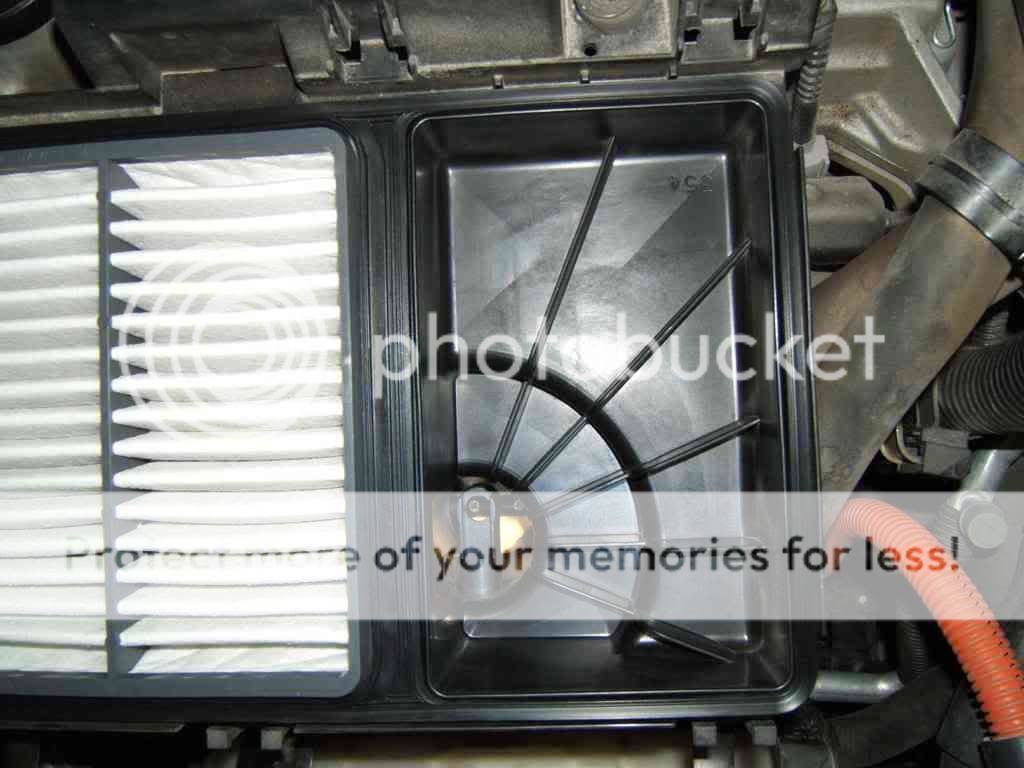

    I did display a photo of my Prius TB. Here we go again:
    Or, a bit further away, with the airbox lid off
    Take the airbox lid off your Prius, easy enough to do so. With a strong flashlight, shine it down the bore. You will notice deposits on the MAF, specifically on the IAT bulb (The hot wires are buried inside the MAF bore, you have to remove the MAF to inspect it)
    I knew it was time to clean my Prius TB when I noticed deposits on the upper side of the blade. You will notice in the photo, discoloration around the edge of the TB blade. When you notice that, the TB blade has fairly heavy deposits underneath
