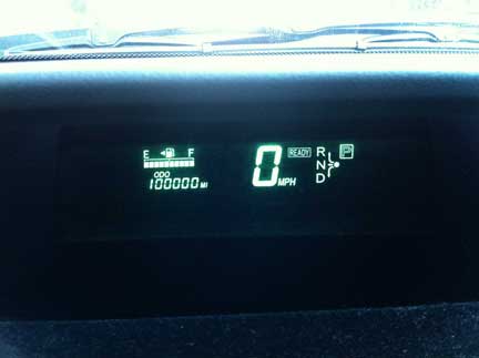

    Woo hoo! Happy birthday to my 2005 Gen II.
    I'd like to be nice to it, since its been so nice to me. I'll look into doing most of the things listed in the original sticky post for this thread. Any other suggestions?
