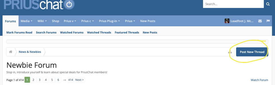

    First, welcome!
    Second, please start a new thread for your case, so we can keep it separate- this really helps us keep things clear and organized.
    If you back out to the forum list view you'll see the button to do that.
