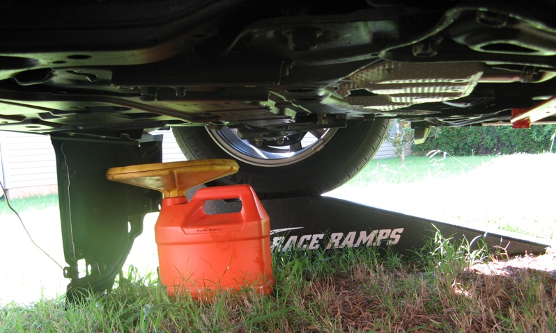

    I like ramps much better, drive up. No jacking and stands required.

    No issues with the Prius being "low" compared to some other cars in regard to using the ramps?
    I have Rhino Ramps I bought to try and DIY my maintenance on my old Civic until I saw someone had stripped out my pan drain, so I ended up still taking it to a shop in case it was the last time the pan could take a plug. Ramps were still useful for checking out noises and such. I was going to buy stands to do ATF. We'll see how brave I get with my new Prius.

    Yes drive the front onto ramps and use a single jack for the rear;)

    Bought a new 2012 Prius last December. Purchased Rhino ramps from Amazon this spring and just did my first oil change, using a TRD oil filter. I found the ramps to be about perfect. They stayed in place when I drove up onto them and the height was excellent for an oil change. In particular, the oil change "hatch" could be held open by the ground without bending it way back (where it will eventually crack). I drove various SUVs for about 25 years prior to my Prius and I can't believe I didn't purchase ramps way back when.

    Agree, two ramps and one jack, car has to be level to drain the old oil;)
    Have a gen 2 and 3, the 2 is a breeze to change the 3's ...different, the cartridge wrench lives on the cartridge, (better dissipation of heat:) ) the door isn't to bad, changing in cold weather is sorta a no-no
