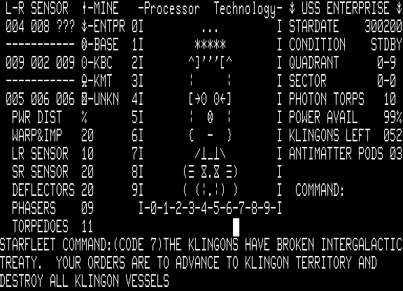

  18. ChapmanF
    28,582
    18,919
    If you were playing TREK80 on a Sol,
    then, for the sound effects, you put an AM radio next to the computer.
    Various timing loops in the program made the trek sounds.
    jerrymildred likes this.
