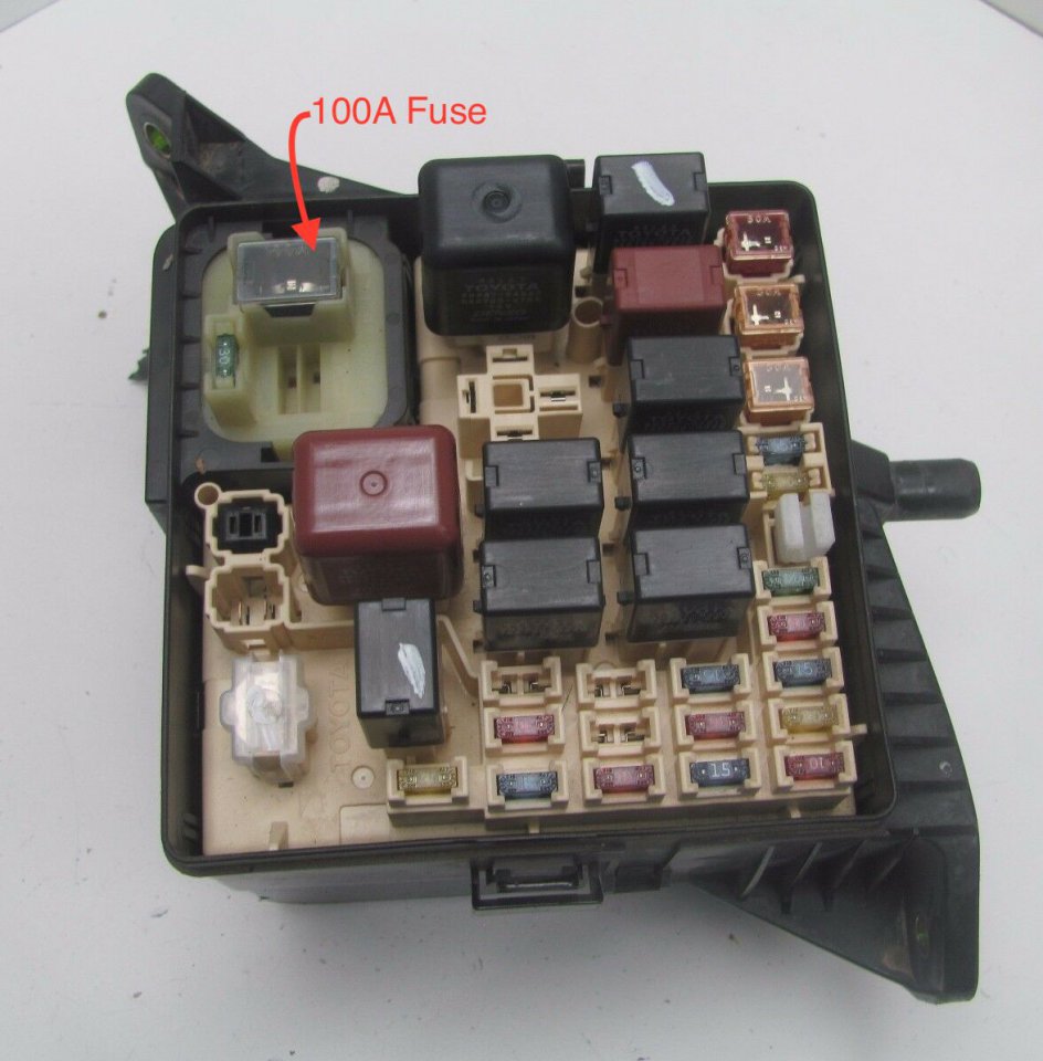

    I did the voltmeter thing as above. At Subaru, off, Subaru battery is 12.48v. Connected jumpers to Prius cables, at Prius cables bouncing around 12.2v. Prius on - 10.86v at Prius cables and 11.86v at Subaru. (Subaru was off the whole time). Would there be any physical evidence that the 100A is blown? If somebody puts a new 12v in there and drives away, I assume it will suck down the 12v and possibly die.

    The fuse is in the fuse box under the hood. It's bolted in so can't be pulled out, but you should be able to see through the little window if it's blown. If fuse looks good the issue might be the DC to DC converter inside the inverter. Car won't make it very far at all on the 12V battery alone, so not in drivable condition.

    Looks blown to me due to the dark gap; if not let me know. Thanks.

    Indianapolis
    Yup, blown and a real PITA to change. Not sure why Toyota designed it so the entire fuse box has to be taken out to access terminal screws.

    So now your car at least becomes a better gamble for a DIY fixer. He can gamble that changing that fuse, or even jumping across it, will result in a running car ;-)
    My guess is the fuse is made difficult to access because 100 amps even at just 12v could well be lethal. So if you're going to mess with that fuse or it's holder make ultra sure ALL sources of electric power are disconnected completely!!

    I looked at the steps in the link you posted and watched some of a video (a different Toyota but looked like similar steps). I'm pretty handy with small projects but to me this looks like bloody knuckles, a lot of swearing, torn hamstrings, and a bolt or two lost somewhere in the bowels. And then whatever blew the 100A will just blow it again. @JohnPrius3005 sure it might give someone "hope" but the other issues still remain - HV battery throwing P3006 and P3009, and cat throwing P0420. I do have a guy interested who has one wrecked from front end collision but it has a relatively new HV battery etc, so he could swap that and the rear end subframe etc onto this one. I have a feeling he's going to disappear though - he's 30 miles away and thinks he can drive it that far.

    The fuse is cheap, like around $2, so might be worth the bloody knuckles and swearing (there will be swearing) to at least get the car in a drivable condition.
