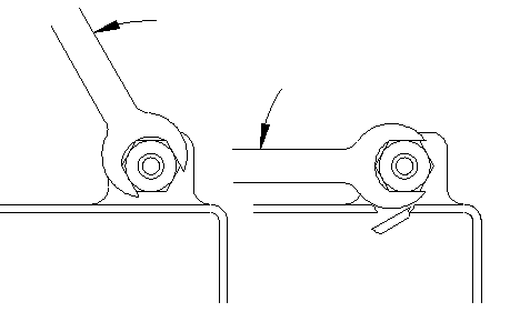

    We do get repeated threads about people busting the valve cover by using an open-end wrench there. In one from a couple years ago Mendel made a nice drawing of what happens:
    You have a lot of leverage in that picture, so even if you are planning to go just a few degrees at a time, if the valve starts stubborn and then lets go ....
    You might get away with doing a test fit of the wrench to find out where it would have to stop, and putting a wood block of the right height under the far end, to definitely stop it there when the valve lets go.

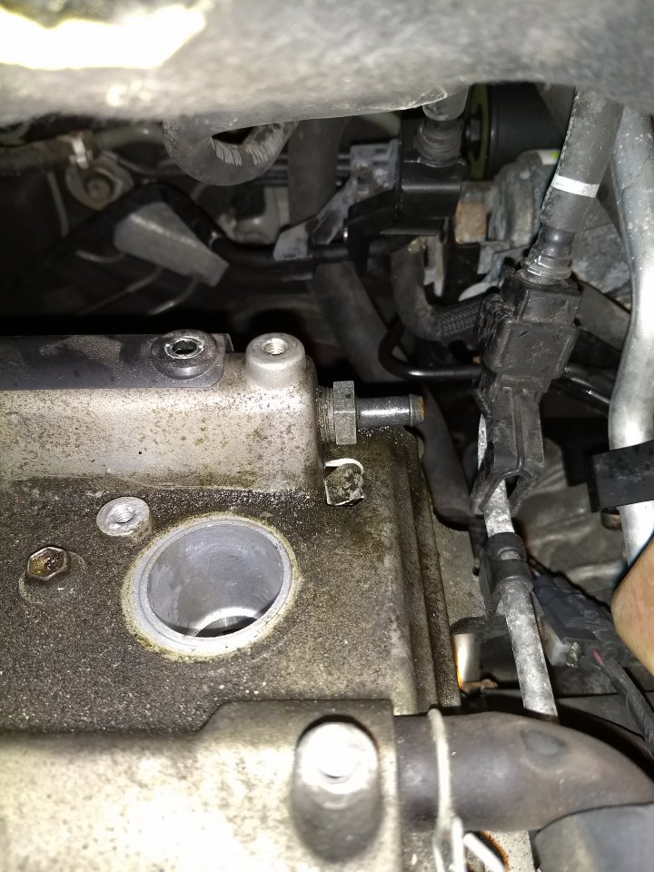

  20. Liam howard
    Liam howard Junior Member
    Jul 6, 2019
    56
    24
    United States
    Four Touring
    I just sent this pic to my bro. Lmao...I’ve been asking his advice too. I wanna see how he reacts when he thinks it’s my car
