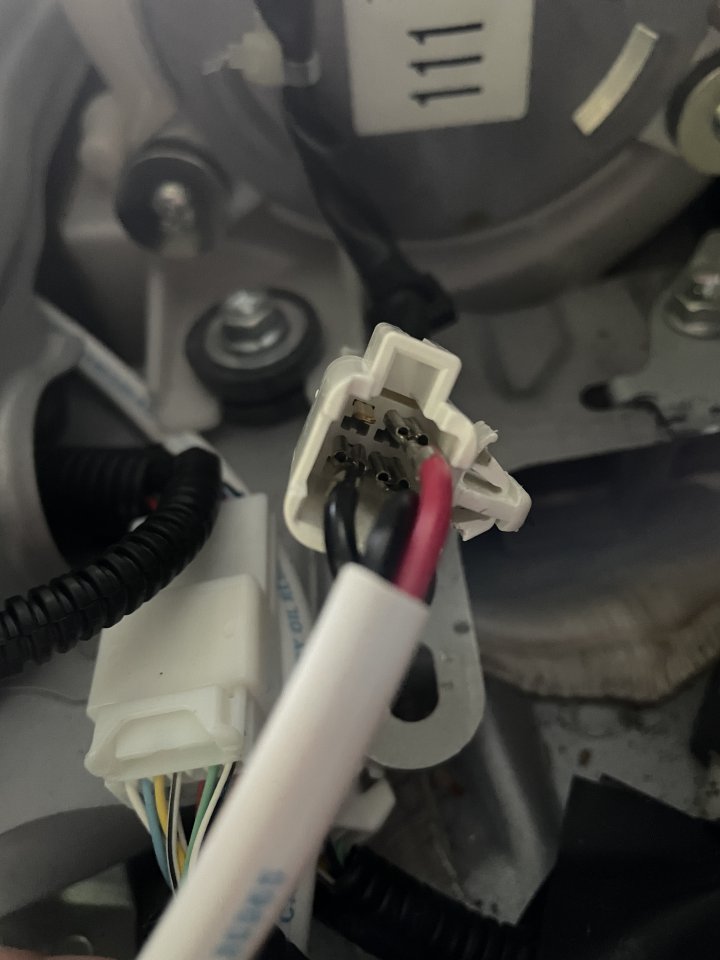

    I would like to clarify the connections you made on the fan.
    The two left terminals go to negative and the bottom right to positive? That's it???
    And can we keep this connection whilst the car is running? My battery blower fan is off when the car is stopped. In a hot climate the fan should blow to try keep the battery pack cool...

    @Panicos I’m not exactly sure how you are looking at the connector, but if you are looking straight on at the fan connector, with the tab on top, the top right is 12v, and the bottom 2 are ground. Just search in this forum and you will see posts with wiring diagrams and pictures. I also have a close up picture of the connection in one of the posts above.
    You can power the fan externally while the car is running, but you will get an error code since the fan is disconnected from the control module.
    If you just want to power the fan to cool down the battery after driving, just use the fan speed option in the Dr Prius app. If you power on the car without pressing the brakes, the car will turn on but the engine won’t run. The app needs to be running, and you can actually hear the fan ramp up when you open the app. It also monitors the battery temperature so you know when to stop.

    i am refering to the photo you uploaded [​IMG]
    is this the correct agle?

    Yep, that’s the right angle, looking directly at the pigtail from the blower. Not visible in the picture, but the 2 black wires are shorted together.
    I’m not sure if not disconnecting and just splicing the wire would cause any issues, since I didn’t try it. However, the commercial offerings from Prolong and Maxx Volts do splice the wires, so it should work. You may want to ask in the grid charger threads.

    Sorry @Panicos, I think my assumption that the Prolong harness splices the fan wires is incorrect. If you look at their installation instructions, they want you to plug their fan control unit between the fan and the control module. They probably have some sort of switch or relay to disconnect the fan from the control module before applying power to the fan. I just want to make sure you know that it may not be safe to apply power to the control module via the fan connector.

    There is a connector that plugs into the fan, after disconnecting the oem harmess connector,
    then you plug that connector into the harness.
    When you run the Prolong charge/discharge cycles the charger and dischargers supply
    power to run the fan.

    Hi @CatNinja, thanks for the detailed records of what you did. I was wondering, when you buy the 90980-10795 part from Toyota, does it come with pins to attach your wires to, or do you buy those separately? Do you know what the part number is if you have to buy them separately?

    Hi @bdc101, the OEM is Sumitomo. Just search for “Sumitomo Type 090 TS”.
    Here’s a place that sells genuine connectors.
    ●[sumitomo]090 Type TS /waterproofing/ female terminal /F090WP-TS - hi-1000ec.com
    Unfortunately, shipping is a bit high if you need just 4.
    90980-10795 is just the housing. You need to buy the terminals separately. It’s cheaper if you just buy the OEM housing when you order the terminals, instead of from Toyota.
    ●[sumitomo] 090 type TS series 4 pole F connector(no terminals)/4P090-SMTS-F-tr - hi-1000ec.com
