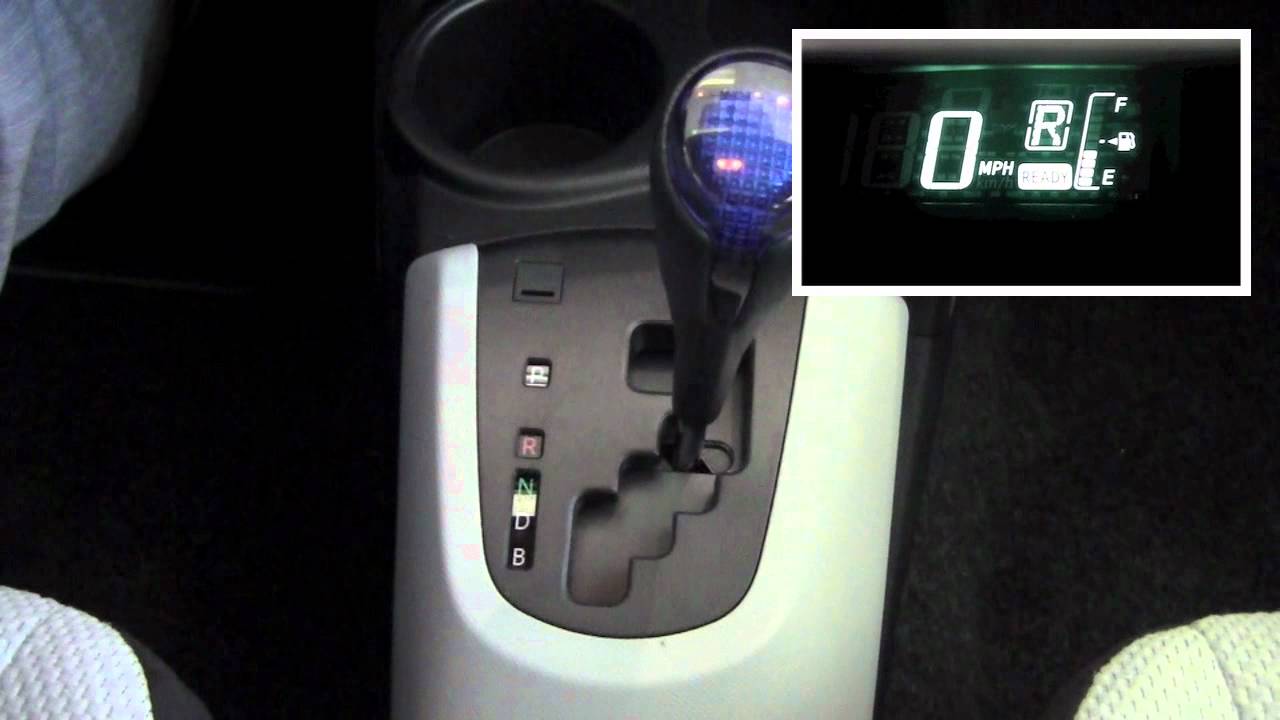

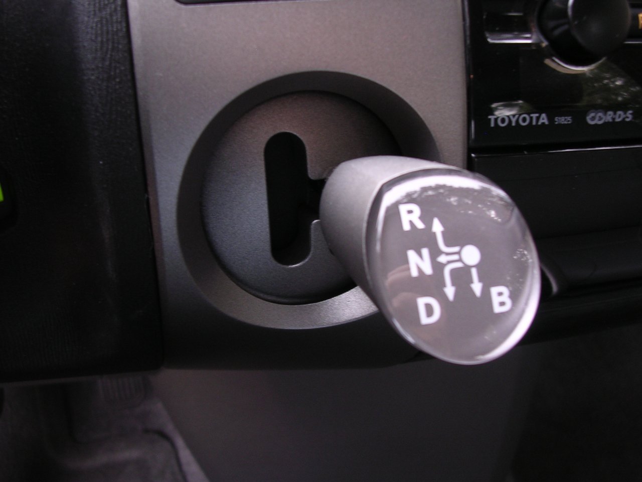

  11. JimboPalmer
    Apr 14, 2009
    12,470
    6,877
    Greenwood MS USA
    Your C stays in R all the time you are in Reverse, in other Prius the shifter goes back to the middle, you can't look at it and know you are in R. (The Camry also stays in R, although I could not find a stock photo with it in R)
    Prius c
    Prius
    Camry Hybrid
    In the NHSTA's mind you don't need a clue, you can see you are in R, but Prius liftback , PHV and v owners can't, so they get constant beeping. (I have no idea why the R in the instrument panel was not enough)
