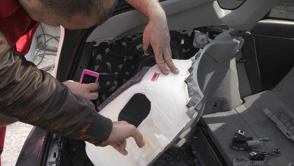

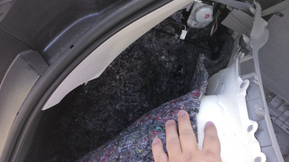

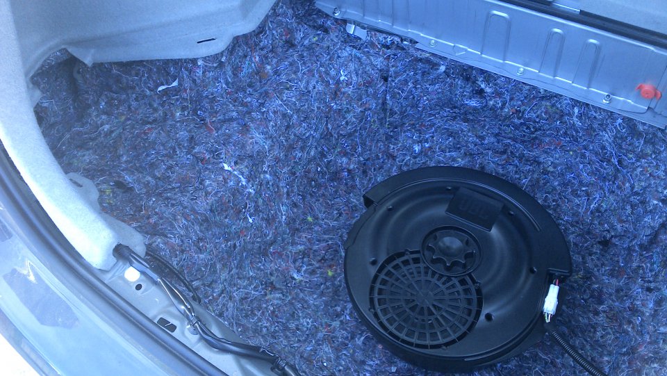

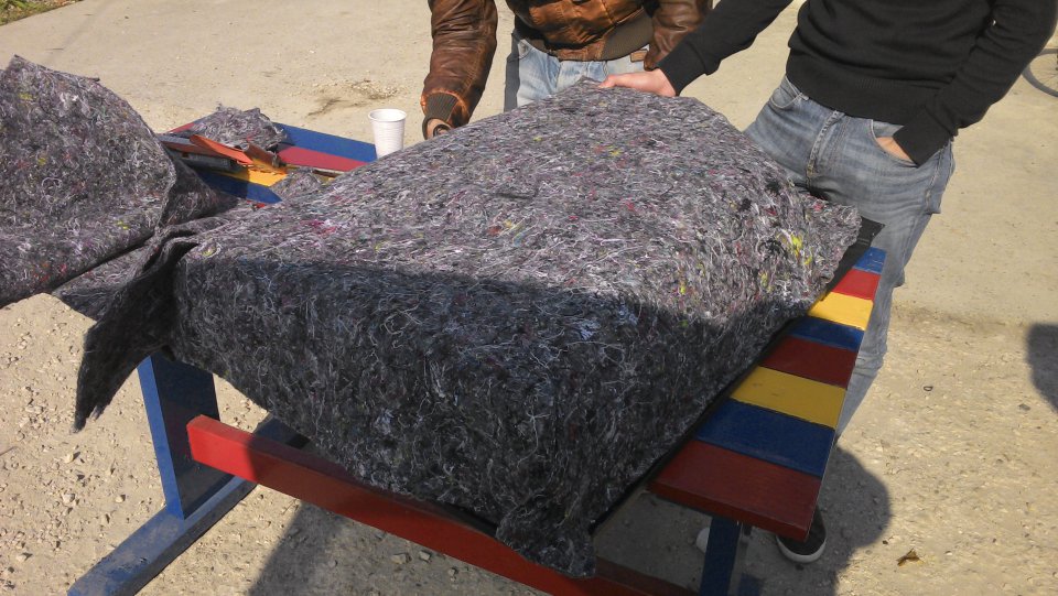

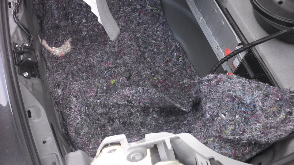

    If you watch the video u`ll see the logo in the sound panels. I also have the subwoofer i the rear back, where the spare wheel is...
    Attached some pictures i did when i insonorizated the back o f my car. Before that, the road noise was louder from the rear, now i hear only the front noise.... Small investition with big sound dumpness effect...
    I also have turn lights on mirrors, and i do not have lane assist. It has radar stuff, i can hook it from the car in front of me , when that car accelerates, my car accelerates, when the car decress speed , my car also does that... It just keeps a safe distance from the car in front, no matter what....
    I drove 500km in the back of a car not pressing once acceleration or break.... Very funny and relaxing....
    P.S I bought the car from Netherland :)))) Actually u saw it on the commercial video...
