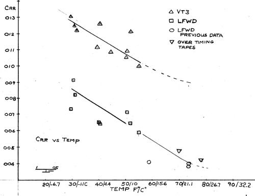

    One most commonly overlooked factor is that air density decreases as temperatures go up.. 10%+ going from 32F to 82F. This reduces air drag and max available power, both good for MPG.
    Tire rolling resistance decreases as well due to higher pressure and flexier rubber; at least until pavement starts melting and getting sticky.
