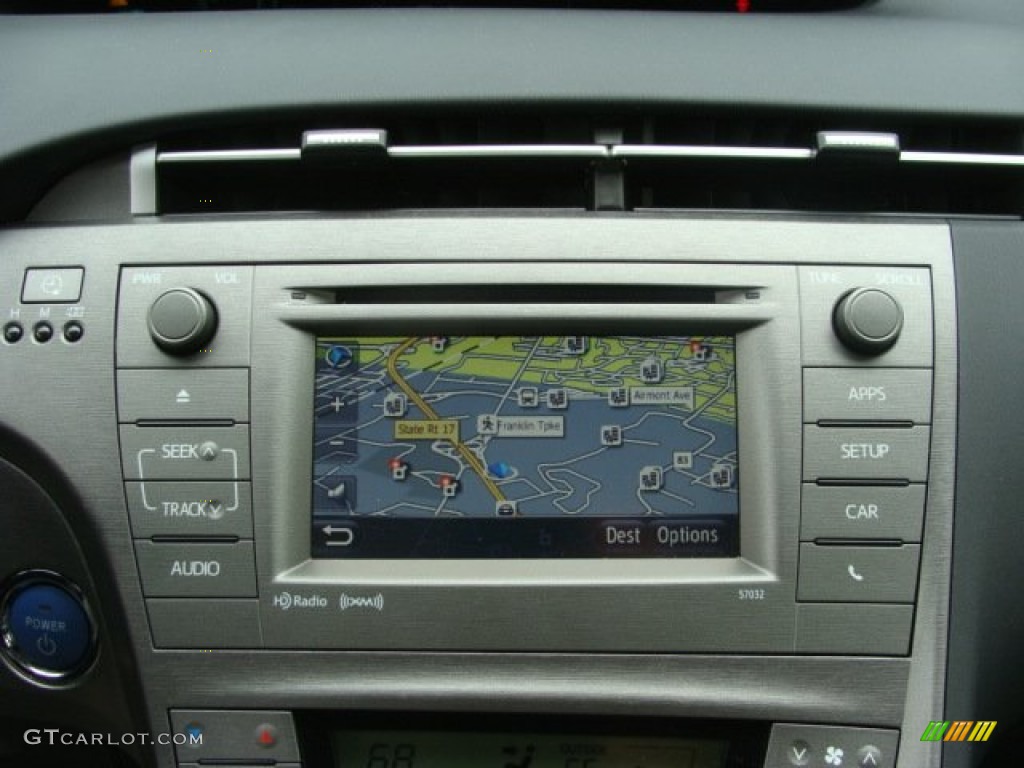

    After going thru this with our TCH, where Toyota wanted $4200 plus labor to replace the unit when the screen died after 7 years, I was able to have my display replaced by an outfit in CA. They provided a video to remove the old unit, send it in, and they returned it with instructions on reinstall all for $385. And that unit was still going strong after another 4 years when we traded the car in recently.
    The 57032 nav HU in our 2012 Prius started sporadically saying "system not installed" when we pressed Apps, sometimes it worked fine, sometimes no dice. This past weekend the display went black, though if you press any button the correct display appears and flashes off after about 2 seconds. So I assume this isn't a simple display failure like the TCH, I'm in for a total replacement.
    I'm not inclined to even ask dealers service department as I know they'll charge 5-10 times the cost of a (way more) sophisticated iPhone - which is robbery. So who can we trust for a replacement 57032? I see them at various sites, and eBay, and I assume there are others here who have had good and bad experiences?

    I just replaced a 57031 with a 57032 in my 2015 Prius, was surprisingly easy. (There's a few YouTube videos on how to do this.) I bought my head unit off eBay for $160. Per another thread regarding the swap, someone suggested running the Entune update. Check out this link and maybe try doing the update on your radio? It can't get any worse..
    Toyota Downloads

    I tried to update long ago, and it didn't take, but I'd forgotten about it. It took a long time this time because I had to wait for the head unit to work fully again - it's been sporadic for months!!! But I finally caught it on a good day, successfully ran the update, and VOILE - it's worked without a hitch for about a week now. We're about to trade the Prius in, so the prospect of having to put money into a replacement head unit for the benefit of the next owner wasn't appealing.
