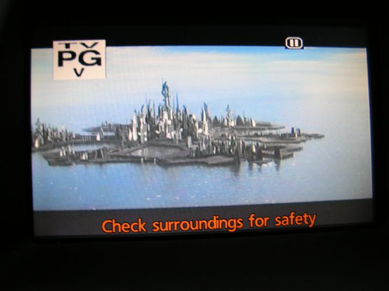

    <div class='quotetop'>QUOTE(keydiver @ Feb 24 2006, 08:27 PM) [snapback]216296[/snapback]</div>
    It is obvious if you look that the prius was designed to fit through a stargate. :p
    Why has it gone silent in here? Why is everyone looking at me? :unsure:
