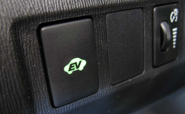

    The EV switch I have came from Canada. It's an official Toyota part that's just not sold directly in the United States. When installed, no one would know that it didn't come with the car; they would have to break open the dash and look at the non-factory wiring connections.
    It looks like the image below. And yes, when the headlights are turned on, the button illuminates.
    Image (c) Darell's Electric Vehicle Page (aka Darelldd)

    Just wired it up to the head light flash. Works good. Thanks for the help. Now when I'm wonder "why is that engine running" I can just shut if off.

    I mainly use it for manouvering around the parkinglot outside our house (e.g. when the rear is parked in the bushes and I need to get at it). No need for the engine to start if I will be turning OFF the car 10 seconds later...
    Or when I'm almost home, my run home has a downhill slope, so I can almost do this coasting. Gives the turbo time to spool down :ROFLMAO:
    My buttons (LHD 2009 Prius II) are placed differently. And they cannot be swapped around (I tried, as the most right one is the blank one and will hold my subwoofer-volume control that I would rather have more to the left...)

    Tony, Do you have a part number and a supplier for the switch. I've never been really interested in doing the mod for this until I saw that switch... That's just too sweet not to do.
