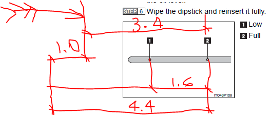

  11. Mendel Leisk
    61,611
    42,382
    Yeah, if there was 1.0 qts remaining, it's miles below the bottom of the dipstick. Tried to do this accurately:
    Maarten28, Tim Jones and fuzzy1 like this.

  14. ChapmanF
    28,756
    19,062
    That's probably only 'accurate' for a non-tapering, straight-sided crankcase....
