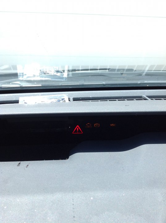

    I was driving my 2005 Toyota Prius and all of a sudden some lights came on the dash. The orange check engine light, The big red Triangle with an exclamation mark on it, the orange VSC symbol, and the orange exclamation mark all at once. I also heard the fans in the back seat kicked in which I never heard before. It felt as though the car didn't have much acceleration. I took it to the dealer and they had it a whole week trying to figure out what it was wrong. They said they got the P3000 INF 123 code from the car which they said the HV control ECM for $2000. Needless to say I don't want to pay that! I found used ECM on ebay for $85 and I bought a scangauge 2 . I pulled 2 different codes out with the scan gauge 2 P0A80 and P3021.
    Do you think the dealer diagnosis is right? What does the codes I read out mean?

    Your hv battery has block #11 going bad. Probably need one or two modules. If you are I

    I see you are located in the Bahamas.
    As others noted, you have some weak cells in block 11.
    If you plan to do the work yourself, let me know. I can send parts and talk you through a few things. Or if you have a reputable independent shop, I could help them as well.
    It's unlikely that you need an ecm. But as you noted you can find a used one for much less than new.

    While the Scangauge is a good unit for monitoring while driving, if you want to completely troubleshoot the battery system, you would do well to get the mini VCI (eBay and elsewhere). This gives you as much info as possible. Your dealer appears to be less knowledgeable than the many helpers here on PC. These reports of P0A80 are becoming almost a daily event now, so you are in good company.
