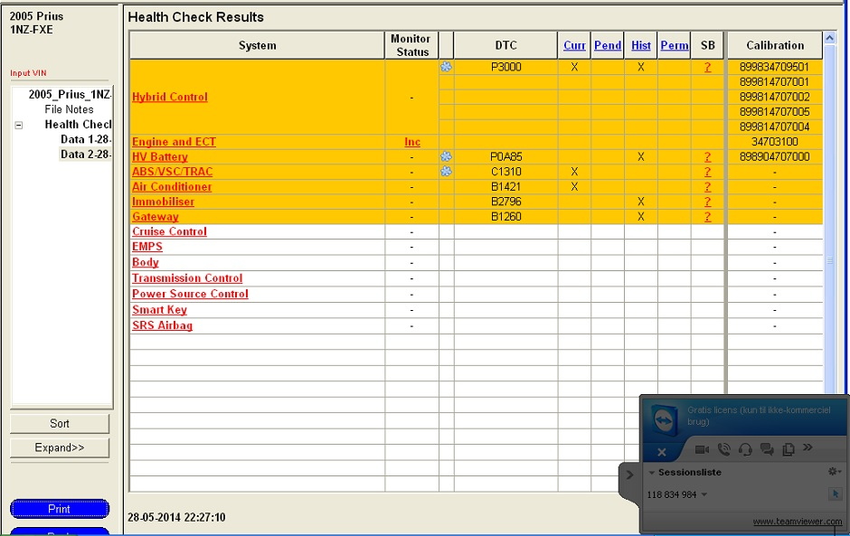

    p3000 battery control system
    c1310 HV system malfunction
    b1421 solar sensor circuit (passenger side)

    P3000 Battery Control System Malfunction
    B1421 Solar Sensor Circuit (Passenger Side) http://tinyurl.com/o4g2rds
    C1310 Malfunction in HV system http://tinyurl.com/op9wkjh
    P0A85 Hybrid Battery Pack Cooling Fan 1 http://tinyurl.com/kawwsae
    B2796 No Communication in Immobilizer System http://tinyurl.com/kpbdv77
    B1260 Transmission Control ECU Communications Failure http://tinyurl.com/lva4lm5
    Hopefully these help you beging tracking down the issues, I'd start with the fan as Patrick suggested (he gave you a good diagnostic tree above). You sould also be removing/disconnecting any non factory wiring just so you can rule that out as an issue while troubleshooting.

    Ignore the solar circuit issue for now. It will not harm how the car functions.
    Unhook the 12v battery for 30 seconds. Hook it back up and rescan it.

    I also had DTC on my Prius
    In the end, the problem was on Battery Blower Motor Controller.
