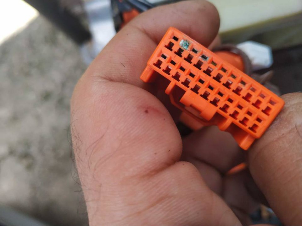

    Doubtful it was replaced if the previous owner only swapped some modules.
    Part # 89890-47092 is the latest being offered.
    You may want to inspect the HV Battery ECU and connector and potential corrosion, take a look at the images in the post below. Notice the corrosion inside the ECU connection point, and missing/corroded pin that is now stuck inside the harness connector
