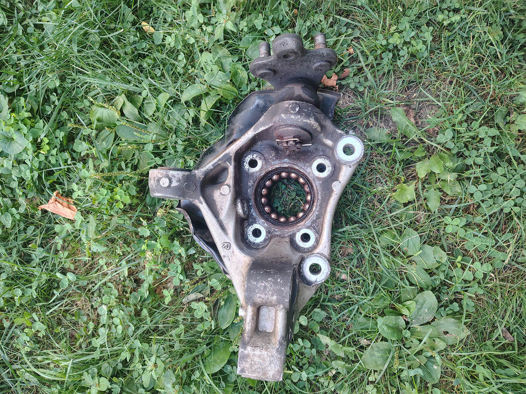

    How important is the dust-cover for the front-brake?
    Finally, managed to swap the bearings. Very difficult as much had not been likely changed ever and stuck together with rust/corrosion. Rotor was stuck to the wheel and it took me forever to get it off. Then I broke off the head of the speed-sensor 10mm bolt (even though I was very careful). It left a nub for the speed-sensor to sit on which I ended up taping (gorilla tape) to the knuckle. its not very secure.
    However I swapped the bearing but don't have a dust-cover for the brake. In my bad-bearing knuckle (which had the only dust-cover available), the bearing fell apart so the bearings were exposed. My partsPrius had the knuckle/good-bearing but no dust-cover. I just swapped it as a temporary fix.
    Very difficult to get the bearing-case out without anything to bang on. See pictures below. I might have to get them pressed out and then take that dust-cover and put it on the swapped knuckle with the good bearing which is already installed.
    Any ideas about how to get this bearing out of the knuckle without taking it to get pressed-out? My car is fixed and drivable but I'd rather drive with the cover on as it might affect braking in rain/snow/etc.

    longer bolts in hub and beat on bolt heads . I've air hammers too never used on this yet

    what do you mean longer bolts in the hub? Do you mean use a longer bolt as nail and pound down into it onto the bearing-housing?
    only thing I can think of is beating on the bearing-housing from the side but that probably doesn't do much.

    There is a method to “jack” bearings out, with threaded rod, nuts and washers, maybe what he means.

    Yes that too . Is a fine method but make up two rods . The bolts holding bearing in get long ones at tractor supply like 3.5 inches put two in catty corner . Now alternately beat on the heads of the bolts sticking up out of the hub screwed into the bearing retainer flange bam bam whack a mole. Crap falls out mess up bolts the coated and 1.89 so . Picture it
