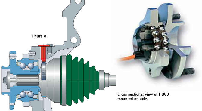

    Prii use hub-bearing units, which are permanently assembled at the factory out of twin rows of ball bearings.
    The ball bearings are configured in "angular contact". You can see the way the inner and outer races are offset, in opposite directions for the inboard and outboard bearings, holding the hub securely in place on its axis.
    People sometimes ask about pressing a hub-bearing unit apart to "just replace the bearings". The picture shows why that's not really an option, though there do seem to be third-party inexpensive replacement "units" that really are a straight spindle and bore with a couple generic bearings pressed in. So, if someone is looking at a car where at one point those kinds of "replacements" were put in for the original HBUs, then it could be possible to press those apart and just replace the bargain-bin bearings inside, if the right size can be found.
