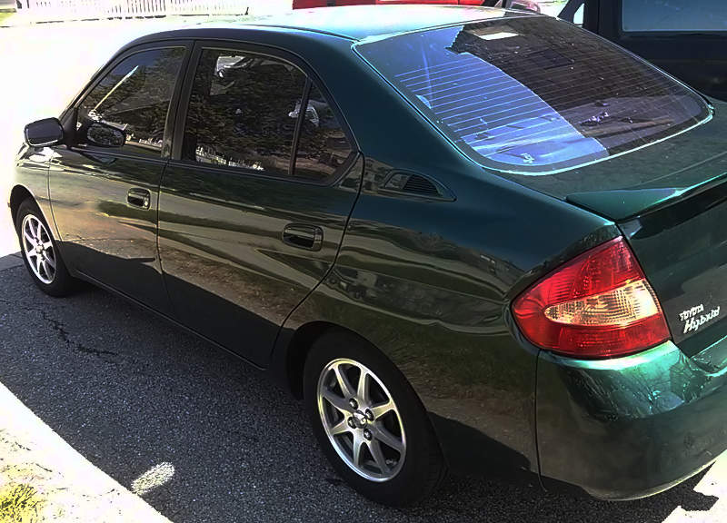

    Sounds very familiar....
    Gnarlesville:
    Off to see the wizard:
    Holy smokes, are those even my wheels?!
    :D
