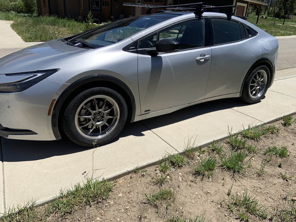

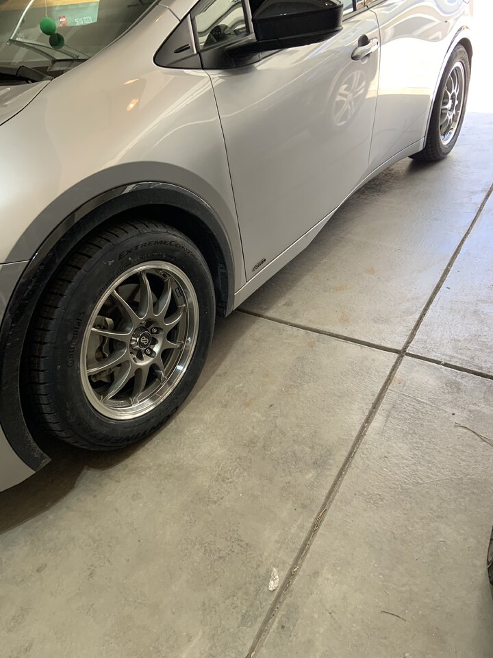

    I upgraded to Enkei 17 x 7.5 with Conti 225/55/17
