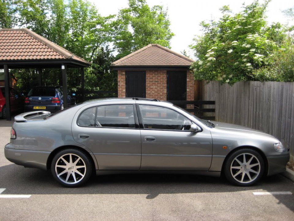

    As all prius wheels will fit each other through the years.
    Will Lexus 18" wheels fit a prius?
    I've seen a nice pair of Lexus gs300. sport wheels and they would look nice on the Prius.

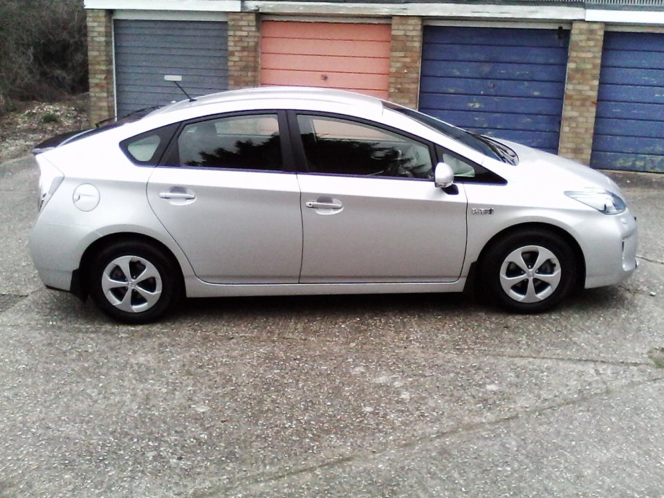

    Now I'm really confused.
    My Prius is a 2014 plug in.
    Will the normal 17" prius wheels fit?
    Hears a photo of mine.

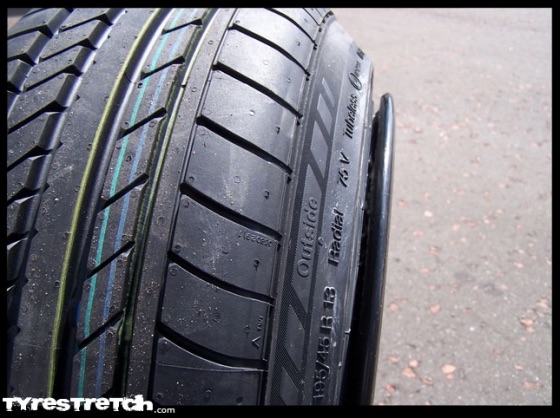

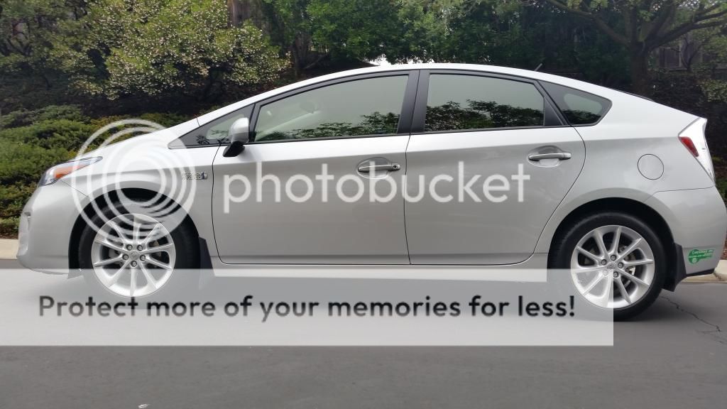

    Ok so now it's been measured up I want to get rid of the rear overhang wheel arch and fill it with tire so it looks right.
    The wheel sizes are. Front 8x18". Rear 9.5x18"
    Now for the front I have 2 size options 215-40-18 or 215-35-18 which is a lower profile. Which one would you fit?
    As for the back with a 9.5 wider wheel what size tire would you fit on that rim.
    Don't want it to look like a prius from Mad Max lol.
    This is not what I want the wheels sticking out like angle grinders and a stretched tire.
    Where as it should sit like this.
    Any advice on this would be great.

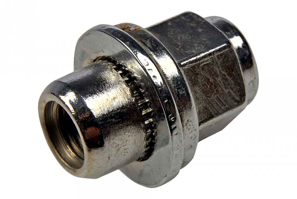

    fitting after market alloys to a Prius is getting a difficult task.
    The factory wheel nuts are like these
    And the after market wheels require a tapered nut like these.
    Does anybody know the size and thread?
    I have read that they should be M12 x 1.5.
    #10 apdevelopments, Mar 17, 2015
    norwood likes this.

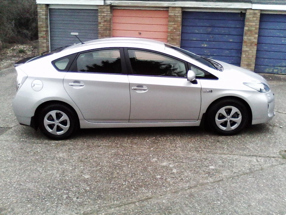

  13. Mendel Leisk
    61,451
    42,289
    Are these your current 15" rims?:
    I would kill for those, lol.
    Seriously, check with a Toyota parts department, see what they're asking for those. In the high $300's I think, each.
  14. tyacrzy
    tyacrzy New Member
    Sep 10, 2014
    whittier california
    yes that's what i had on my Prius plug in
