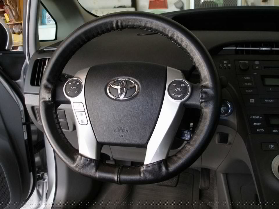

    Finished up this afternoon. I'm happy with it even though got more bunching on the 9 o'clock spoke than I'd hoped for. Someone recommended 'don't pull too tight on thread or cover will bunch up'. Sounds like pulling too tight stretches the cover around, then there's a bit too much so it bunches up a bit.
    I drove to the gym with it and it feels so much better than the rough plastic surface. This is a good modification. Now I want to try to protect it from too much blazing sun. May toss a small towel over it at work or when parked in same position for hours. Here it is. Even though it doesn't look 'OEM' the feel more than makes up for that -

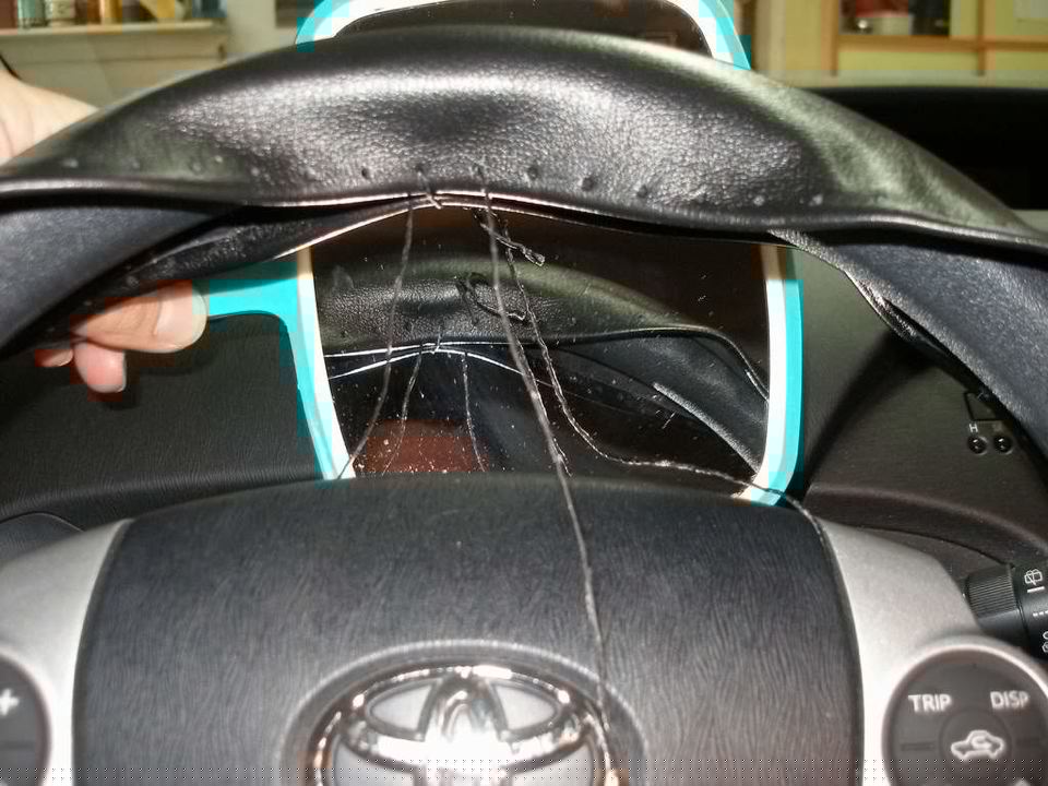

    Before starting, decided to start at tip of wheel to get practice on rim before hitting hard part, a spoke. Don't know if best place, I'm a rookie. Mirror came in handy.

    Have to say the feel of the Wheelskins unperf'd leather is pretty awesome. So much nicer to turn the wheel and feel that nice leather as it slides back through. I would do this mod over again.
    Minor bummer the cover over spokes is not so tight, but I think I did pretty good overall for a rookie.

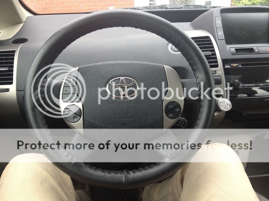

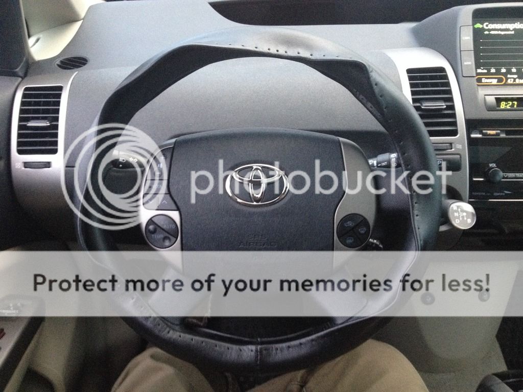

    I have a 2007 Prius. I added a Wheelskin two nights ago. Turned out pretty well. We have one in my wife's Camry and another in my Miata. Great product. The trick is: take your time, pull tight, turn on the car and rotate the wheel (when needed) so you are always approaching from the same angle. Most importantly, when doing the dummy stitches around the spokes be sure to count the exact number of missed holes at the back. I insert the tip of the needle in the back holes to count. If you screw this up you will have extra holes on one side at the end (and it will bunch).
    Before
    After

    Looks really good. the lacing above. Wheelskins is up in Berkeley here in Bay Area. They can lace one up for $40 in a short time. FYI.
    Good modification. 10x better feel than the sandpaper plastic gen3 wheel.
