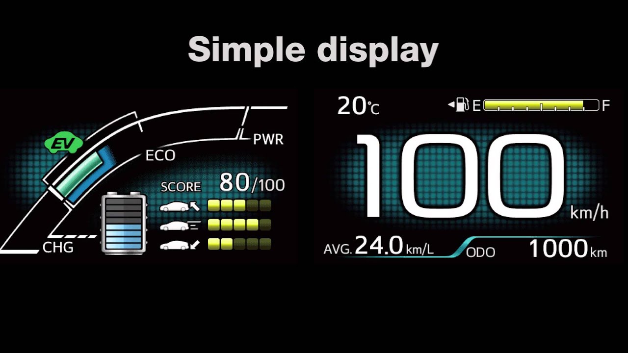

    There is no speed limit on electric power. However there is output power limit and I believe the limit is placed well below the maximum output of the electric motor as the battery is not too big in the regular Prius. So if you look at the dash there is an initial interval of the output torque where you can benefit from electric only. If you step on the gas firm enough to demand more torque the gas engine will kick in possibly aided by the electric one.....
    If you keep the torque in the EV sector and battery is not empty and car is not cold - you are going all electric.....
